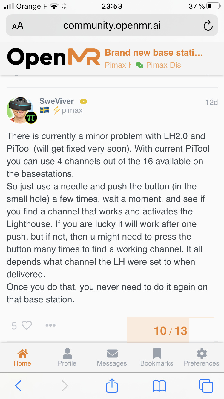

I’m Pretty sure to have read recently by a Pimax admin that pitool could not yet recognize more than 4 base station whatever steamvr is able to.
But can’t find back the post.
But if only one of you had the experience of having seen one or several pimax headsets being tracked by more than 4 base stations at the same time, then it makes my day. And my problem is not one anymore. :+1:
I have seen 7 lighthouses (on different channels) in SteamVR being green (i.e. recognized), but I do not know how many of them were actually used for tracking, so it is possible that only 4 can be used - which is probably more than enough anyway.
I believe the problem with Pimax (unless it was a misinterpreted) was that Pimax can work only with channels 1-4. In this case, it is not a problem with the lighthouse tracking but with the way Pimax uses it and in this case, you will need to track all headsets with only four lighthouses set to channels 1-4.
i found it back, unfortunately :pensive:
I still don’t get the point that I often read that it can only be set between 1st and 4th channel
