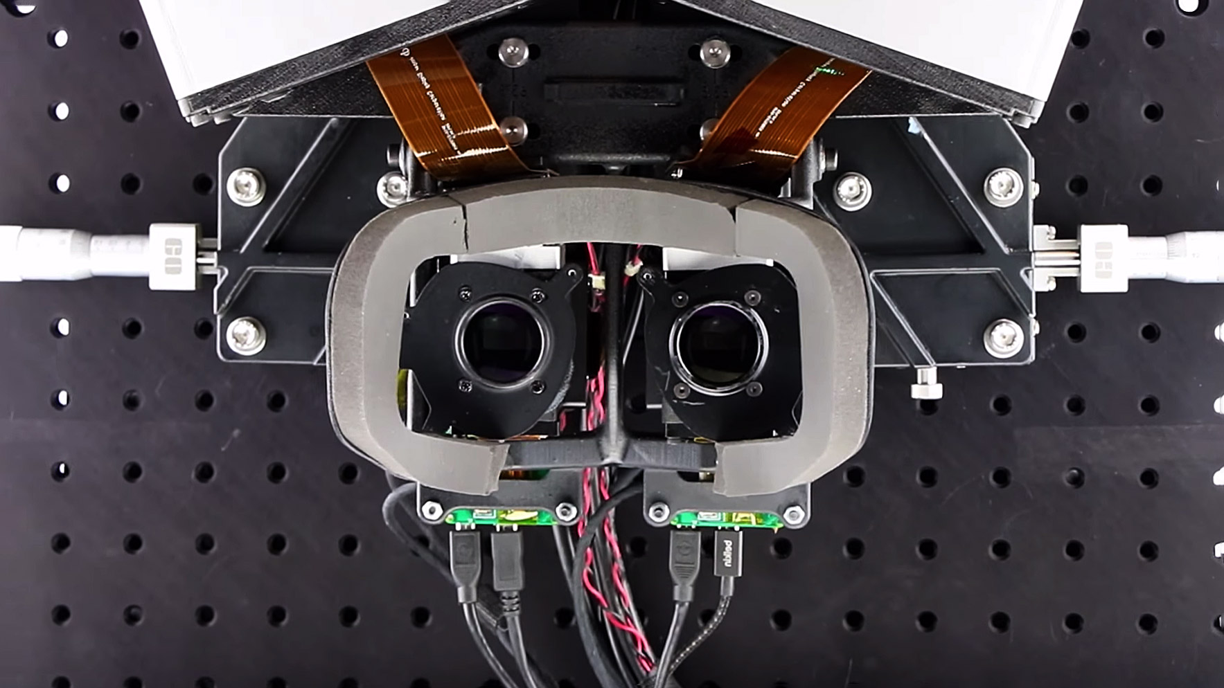

This kind of stuff is not easy to say the least. Right now the closest we are to variable focus is with a patent by Oculus: Oculus Research to Present Focal Surface Display Discovery at SIGGRAPH

This is the one stand-out feature which is said to set the mysterious Magic Leap goggles apart from the rest of the players. They certainly are making a big deal out of it, and it isn’t clear yet due to their non-communication policy, what they have achieved and if it delivers the big Wow-factor everybody is expecting from it.
Oculus are also working on it, and if I recall correctly, even the CV2 if released in 2019/2020 would not yet necessarily have such capabilities, it is rather a long shot research they are conducting.
