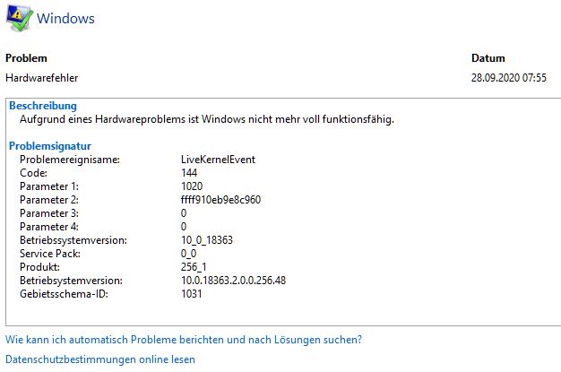

Furthermore, I noticed yesterday evening, that when putting my 8K-X to real stand-by via the HMD’s button, I always get a hardware error event #144:
8K-X Hardware-Event 144
Even more curious, that event occurs only ONCE per Windows session, between boot/Windows LogOn and shutdown/Windows LogOff. Means: I can relaunch the 8K-X and put it back asleep multiple times during one and the same single Windows session, but that error #144 occurs only the first time.
Fortunately nothing more happens, everything works and runs, standard flat gaming as well as VR, no crashes, no BSOD or the like.
However, a bit curious, annoying and unusual, too.
I will double-check that by updating my NVidia graphics card drivers - but together with that USB-2.0-issue, that sounds rather uncommon to me…
I’ll keep monitoring and probably open a new issue topic on that so @pimax doesn’t have to read through all this topic here :wink:
EDIT:
NVidia drivers updated, played an hour Elite Dangerous in VR.
Pressed the HMD’s power-off/-standby button - and once again hardware event 144 exactly at this point in time (I did a reboot after driver update):
So, this problem isn’t related to the graphics card driver.
Can anyone reproduce and confirm? => Reliability Monitor
