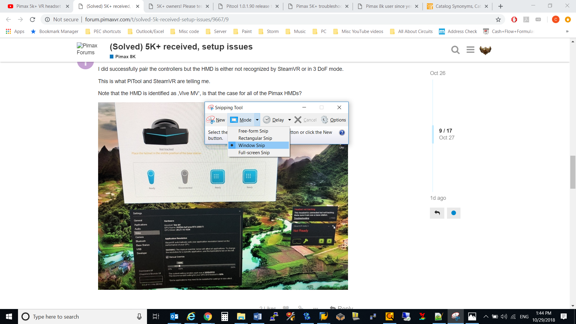

I did successfully pair the controllers but the HMD is either not recognized by SteamVR or in 3 DoF mode.
This is what PiTool and SteamVR are telling me.
Note that the HMD is identified as ‚Vive MV‘, is that the case for all of the Pimax HMDs?
Yep, identified as Vive MV here too :slight_smile:

If you are trying to take screenshots your best bet is probable the Snipping Tool (included with windows) or the Print Screen button (copies to clipboard, then paste into Paint/etc). In this case I used the Print Screen button to take a picture of the Snipping Tool (insert Inception noise).
This will usually give you better image quality, lower file size, and easier acces to files (if posting from the same computer).

Thanks, I’m quite aware.
Thing is, I’m perma logged into this forum on my phone and on my work PC, not my gaming PC. As I have no clue what my pw is and the Pimax reset pw function appears defunct, I had to literally photograph my screen on my phone and upload via that.
