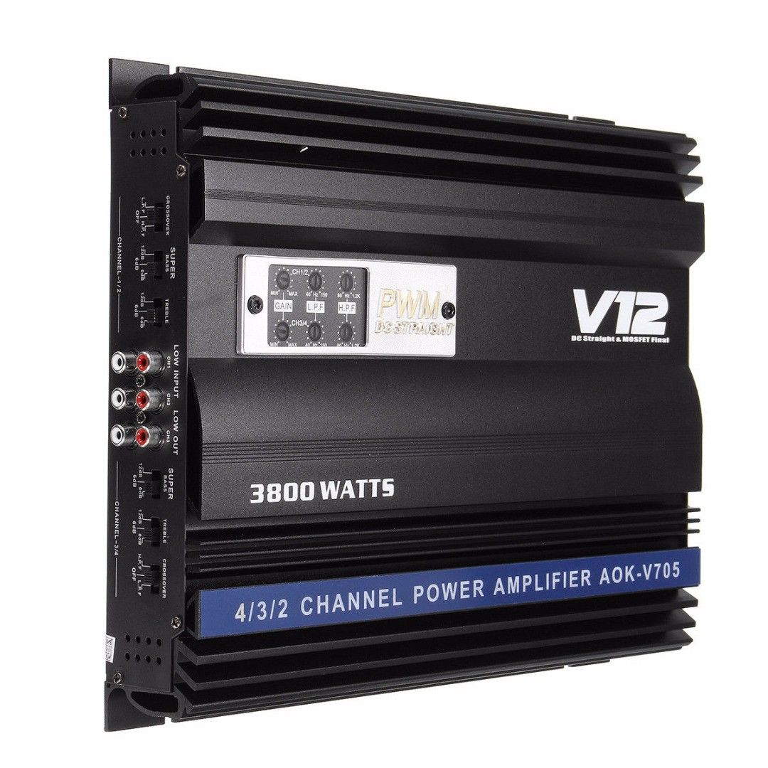

The amps you use just have to handle low frequencies well, as that is all they will be amplifying. You need powerful amps, iirc mine are 160 watt per channel and buttkickers can take 200 watt per channel. You don’t need audiophile quality so you can actually get very cheap amps that work well.
i found this and a power supply 40a i was thinking with simvibe and four Reckhorn BS-200i Bass Shakers what you think or i can get pioneer 4 channel amp good for 100w continuous over 4 channels @ 4ohms
