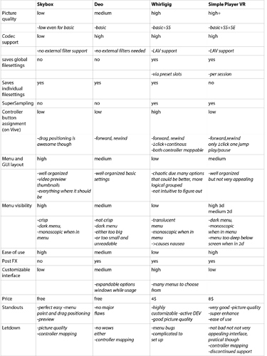

Here a chart that I made quite a while ago, check my comprehensive vr player thread for more Info (there are no new players so I didn’t update)
But I can update that I find whirligig best for normal 2d movies since it got a feature to curve the picture verticaly and horizontaly which makes you see more at the same time without moving your head.
