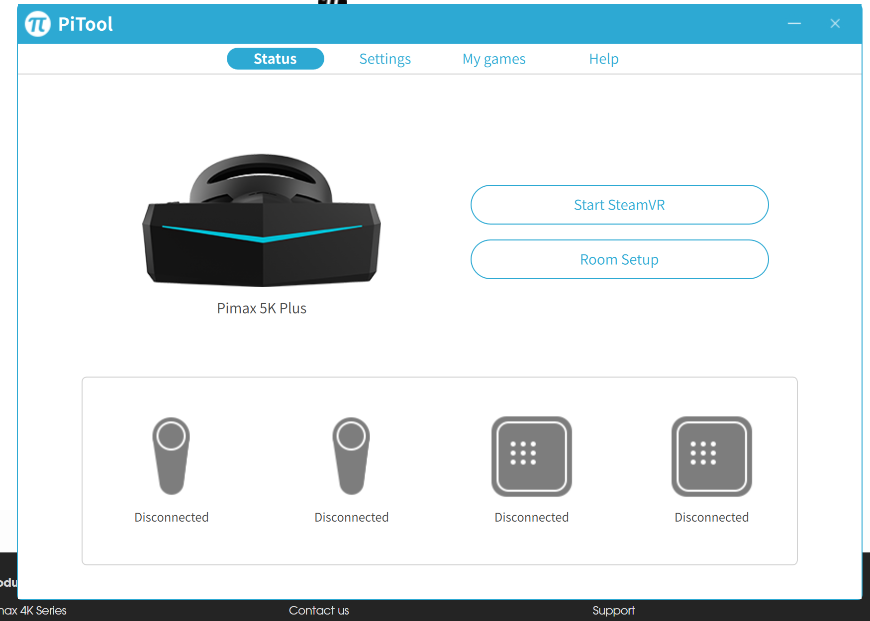

As the subject says; I received my 5k+ headset. I’ve had a working Vive for over a year.
I updated my nvidia driver to 417.71 (current version)
Installed the latest PiTool
Ran PiTool room setup. Headset appears, but controller and lighthouses are shown as disconnected.
I tried to run SteamVR room setup, but only the headset appears in the device list. My controllers and lighthouses are no longer visible in SteamVR.
I can see a space landscape in the headset. I can turn my head, but my POV is locked to the ground. I cannot move vertically or horizontally.
Help!

Yes, they are 1.0. I’m not sure how to ‘wake them up’, but I have unplugged them and plugged them back in. Lights are green on both. Restarted PiTool and SteamVR. No change.
Update: I disconnected the pimax and reconnected my vive. Lighthouses and controllers are recognized and operational in SteamVR. I disconnected my vive and reconnected my pimax and the controllers and lighthouses are not recognized nor operational in either PiTool or SteamVR.

Have not had much luck. I have a support ticket open from a week ago but last time i heard anything from that was to delete the lighthouse files, which i’ve done dozens of times. The only thing that has shown any promise was to run my Vive fully connected and then fire up the Pitool, this way the lighhouses on there show as blue, with only one tracked though, the only thing is that the headset reports as not being tracked.
So I “improved”(?) from this:
this this:
I’m giving up for now until the next version of Pitool comes out or I hear from my support ticket.
