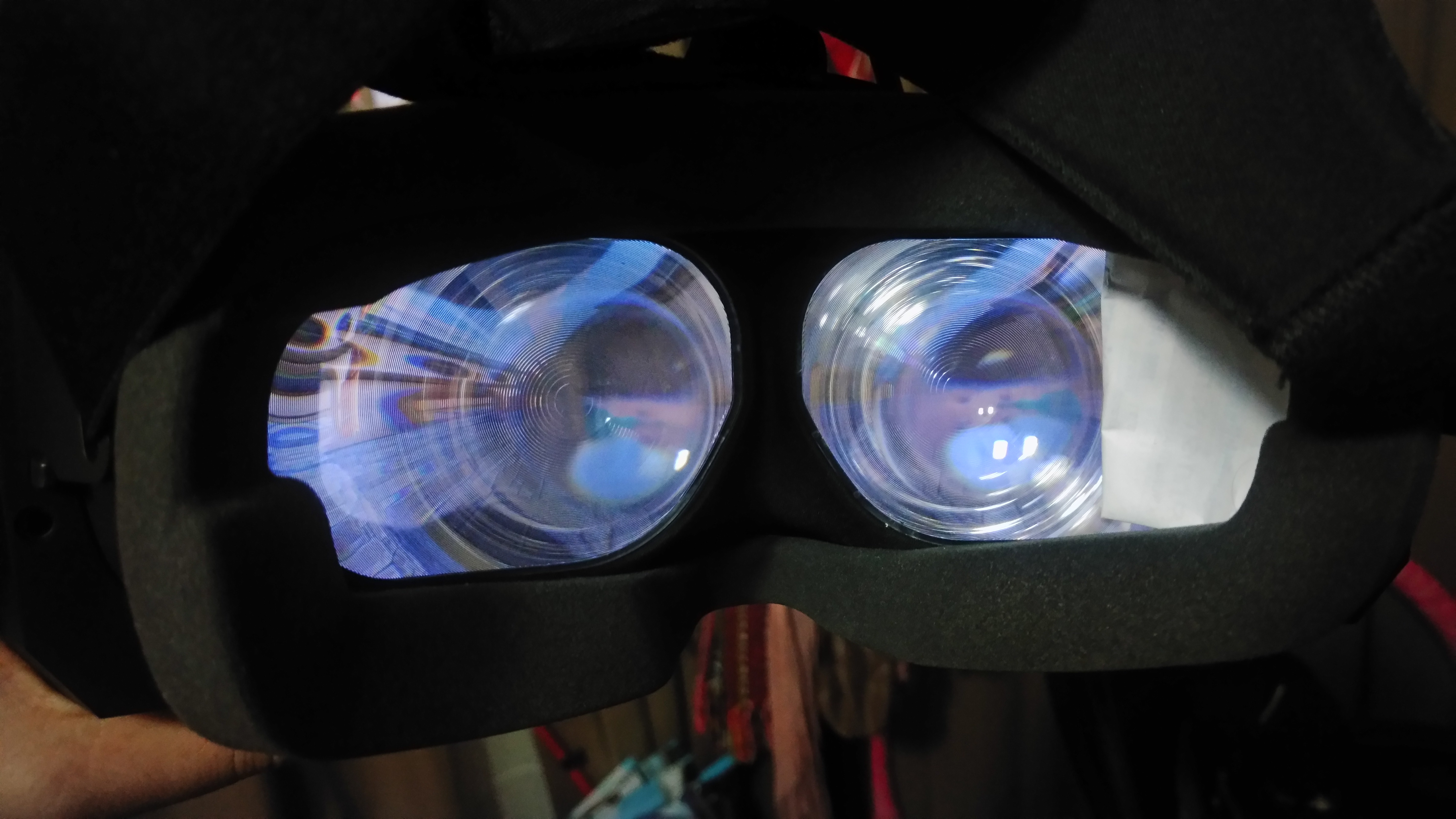

  1. Lenses is convex lens, the flat part is deeper than the circle center. When you close one eye and move the lenses to your eyes, you will found that you use only that big circle center
3.1. So may you not look to flat part directly, but from center into the lenses to the flat part
3.2 The 3.1 still not be final answer, reason is when you use 2 eyes, you can see wider image than closing one eyes, you will found that you can see inner edge of opposite side easier and get some light or some moving light around the center for a little bit. So you may have a chance to see some image from the flat plate too if your eyes is far from the lenses.
There are 2 method to check.
  1. use some wall to block the flat part.
  2. use some tape to cover the flat part.
    These 2 method to check that how eyes work.
I have low ipd, I can’t avoid to see the inner edge of the lenses and I have a small nose, so I need some wall to block the gap between my nose and the headset.

  1. I try to close one eye and found that I can see some black area of paper in the right eye, i assume that the eye look to the flat part directly.
I use large mode and still can’t see more area at the right, so this flat part is important for bigger fov.
  1. I close left eye and turn around and follow the clockwise, still see some little distortion, I think that it come from the edge of the circle part of lenses.
  2. I close right eye to compare, turn against clockwise. I found that there is distortion at both of inner and outer edge, so the area around circle still have some distortion.
This is distortion issue, so I am not sure that this will be same the issue of world movement.
Other Tip : When you stay in steamvr home, try to use controller move around like a circle in front of you, if you see little black moving, you need some wall to block between lenses.
i will cut better paper to block from circle of lenses to face pad and check again.
I remember we did this with paper cuts during the beta phase :slight_smile: It showed that the flat part of the lenses only is covering the last 10 degrees or so (on each side), of the peripheral vision.
