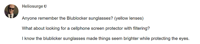

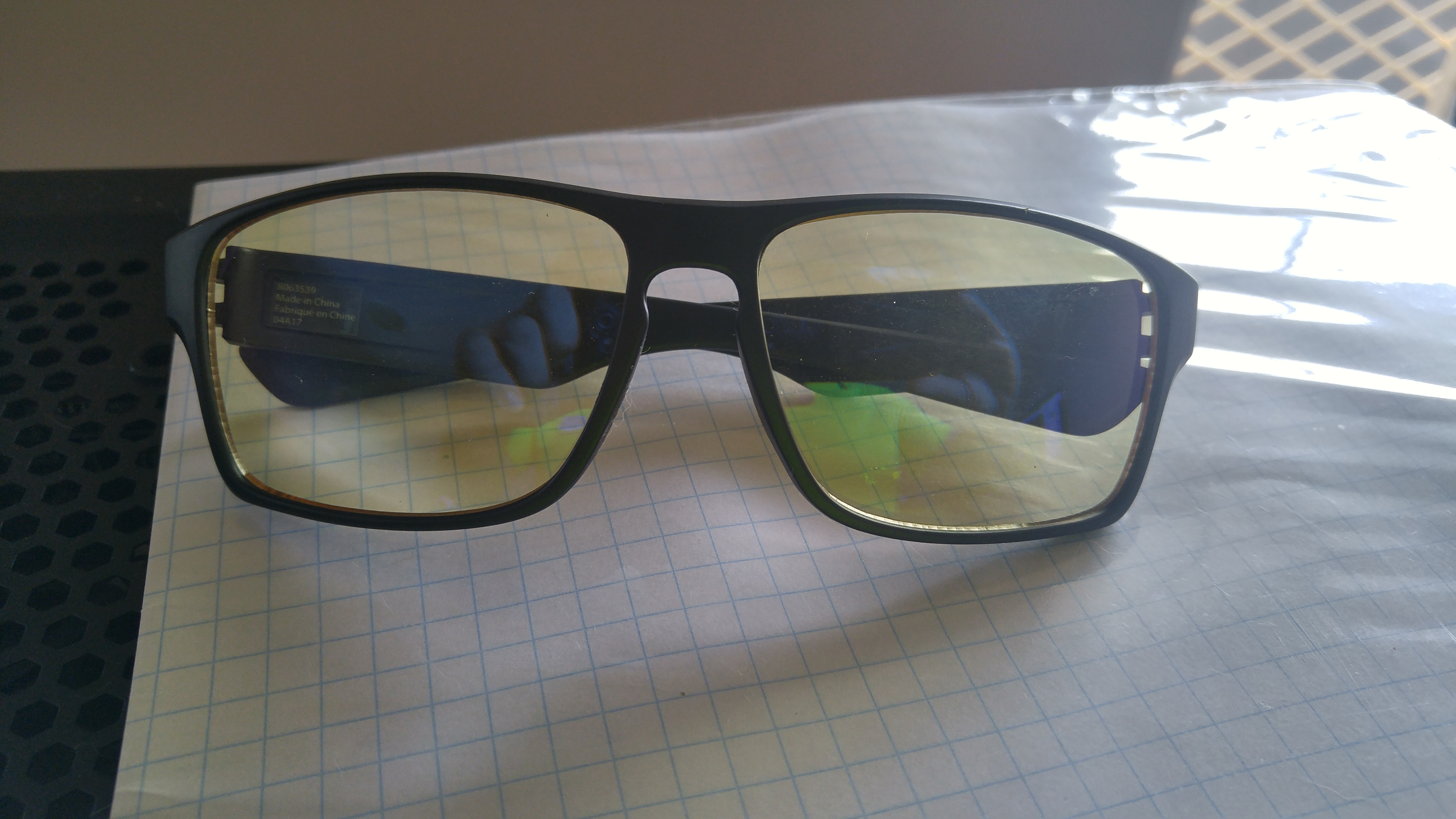

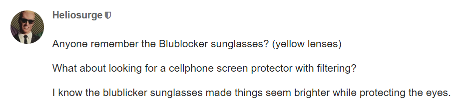

Here are. The gamer glasses
The Amber color of the glasses is used to improve the picture. (night driving glasses do the same to brighten things up)
About glasses -Amber / yellow tint glasses have higher blue light ‘protection %’ than clear type, I believe.
@Heliosurge Those glasses look good I will check into those.
Keep in mind if you read the gamers glasses the amber serves to help improve visual quality.
