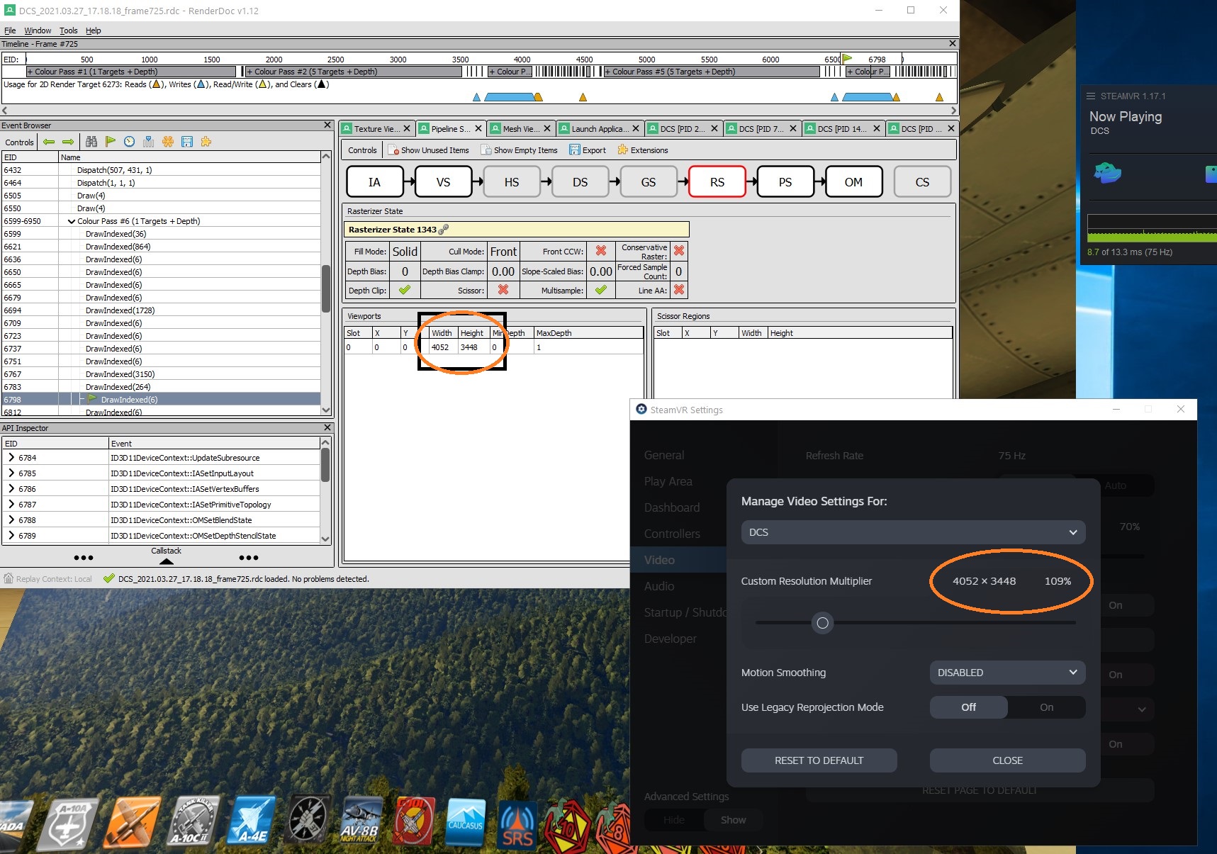

Very True! But don’t get hung up on the SteamVr percentage - Always look at the final rendered result in SteamVr > Video > Per application settings - for final rendered resolution. I have measured it and the output matches what the settings say. Understand the resolution you are trying to finally hit at the end of the render pipeline.
I have a 3090 OC and a i9900KS running at 5.2 and I only use Pitool at 1.25 then the final adjustment in SteamVR.
Add images
4050 x 3450 – not bad
