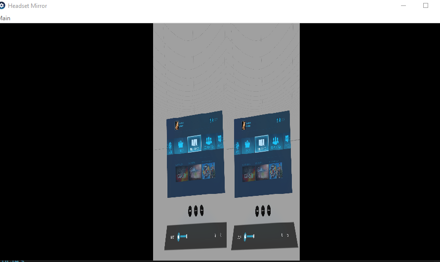

I can see revive dashboard sometimes but with poor graphics and poor color.
Also can see this:

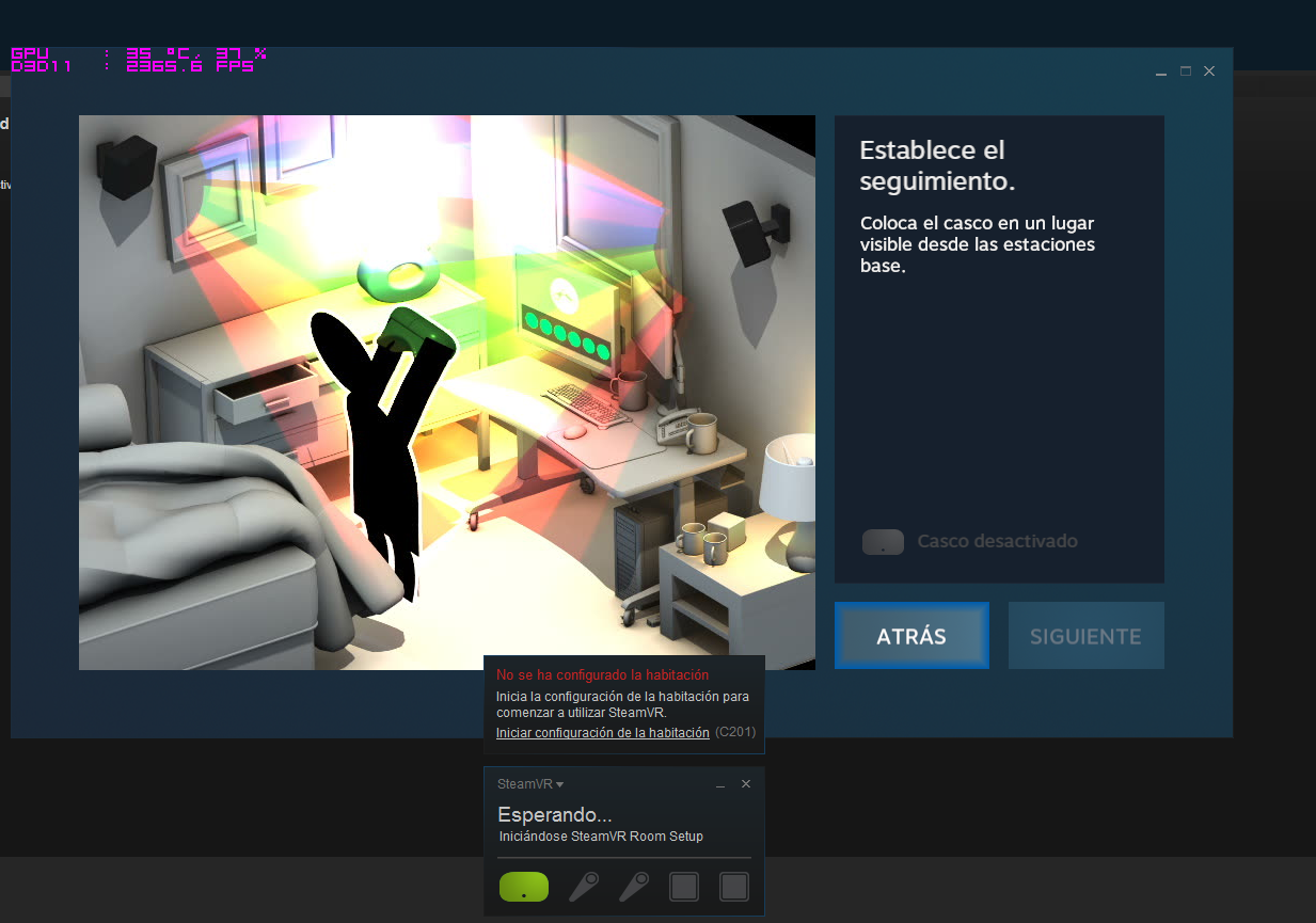

Main problem is scale room on foot config because can’t launch any game because groud parametres are not ready (or something similar)
The headset shows full green at little steamvr window but the can’t recognize it when I want to do the room scale on fit config.
Thanks for the help

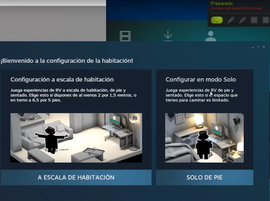

I see at videos that:
The vive must put READY o PREPARADO before config room scale (see pic,is not mine of course(.Mine put NOT PREPARED.
So the problem is before this step but no idea what more can do because mine put NOT READY but the icon of the hdm is full green.

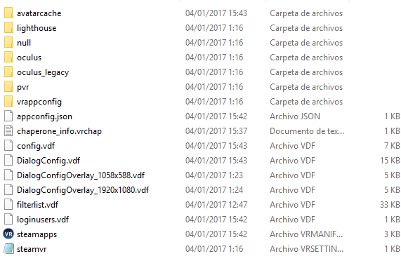

Ok, this is a long shot but copy/paste this in a text editor & save it as chaperone_info.vrchap (It’s a Standing Room Setup already completed).
Place it in X:\YourSteamDirectory\Steam\config folder.

EDITO:No changes,the problems still here.
Thanks again :slight_smile:
You are going to have to change that chaperone_info to an actual .vrchap extension. (currently it’s still has an .txt extension).
See here: http://www.thewindowsclub.com/show-file-extensions-in-windows
Thanks!
I take the one I have and chaged the content
Go to try!
