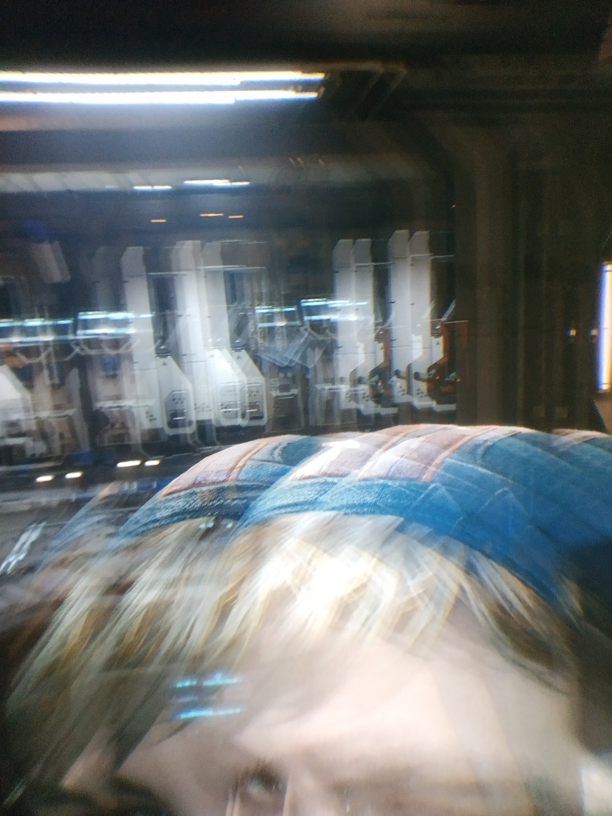

This is what I get in almost every games with this 1.129 as soon as I move my head, don’t know how to call it, some kind of frame delay/ghosting.
Any idea what’s causing this?
(This is not related to PP, I see the same thing even with one eye)
Have you tried with much lower resolution / SS / Pitool quality level ?
I could be wrong but i think that from the game’s point of view, one big difference between PP / non-PP is the res it renders before passing it to the next stage (distortion profile or whatever).
Take your PiTool render setting down to 1, bump your Steam SS both Vid and App to 100% and get rid of your AA and see how the image looks then.
Looks bloody brilliant on the 8K and aside from higher res panels - it is being fed the same res from the computer as the 5K.
If you worry about speed, then PiTool Render at 0.75 works a treat too.
To be honest I dont see a point by doing your way. My input resolutions with PP ( IL2 need that) is high enough to get struggle in Kuban map near ground with dips below 70~65 fps. My input res is around 3750x3120 showed by steamVr app.
Are you tell me that SteamVR SS render engine is better than Pitool render ?
