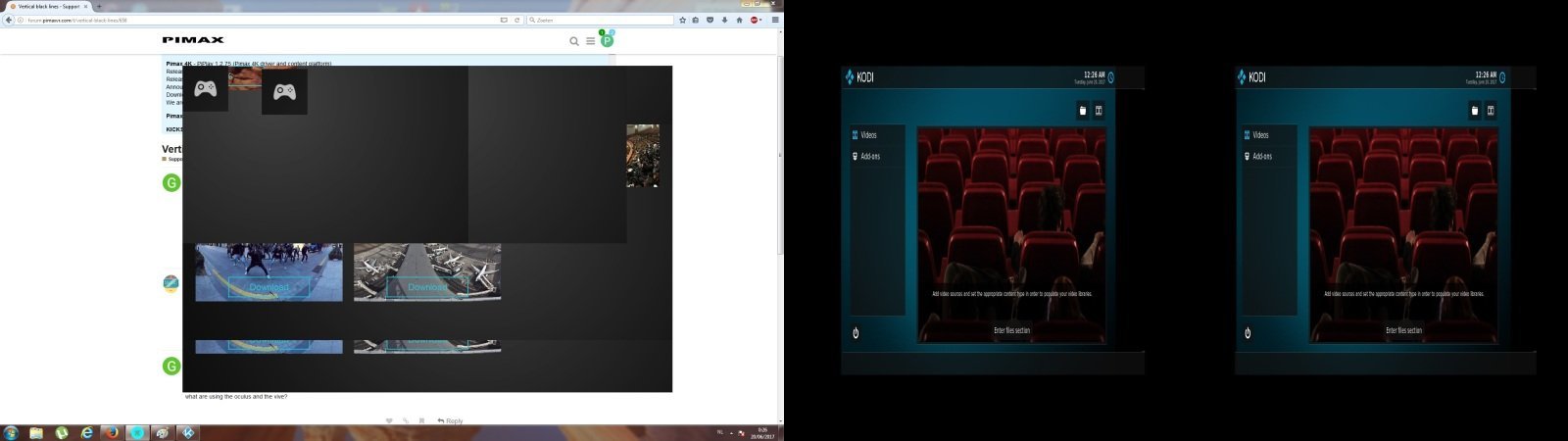

Now the issue that I have now is that the Piplay application flickers when I hover about the buttons that arenā€™t even visible. Multiple overlaps Making it hardly readable/usable on my monitor.
Now in videomode. It kinda works with extended display. No disconnects. The Kodi application works more or less on the Pimax I can see the theater seats. I can drag internet windows to the hmd and when I tried a youtube VR movie about a rollercoaster VR game it displayed correctly on the Pimax as if I were running the Rollercoaster VR application myself.
As soon as I switch to Pimax mode. The HMD keeps disconnecting with an endless Pimax radar loop where it keeps disconnecting - searching. So installing SteamVR is no go for now. Iā€™m stuck and I would like some help from here.

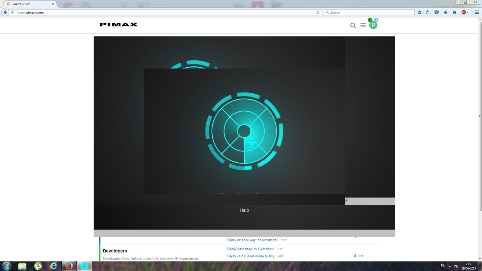

http://i66.tinypic.com/34ozzwi.jpg ā† This 2nd screenshot explains it better

The flickering and overlapping issue is solved.
I disabled anything onboard gpu graphics related option in my bios.
And when I disabled my overclock on my 7950 (factory overclock) the flickering stopped.
At stock 7950 speeds, no more Piplay issues.
Now Iā€™m still stuck with activating Pimax mode. No change there.
Searching device -> has disconnected
endless loop
As soon I try to activate Pimax mode, the pimax disappears as 2nd monitor in windows display options. Never to be found again.
