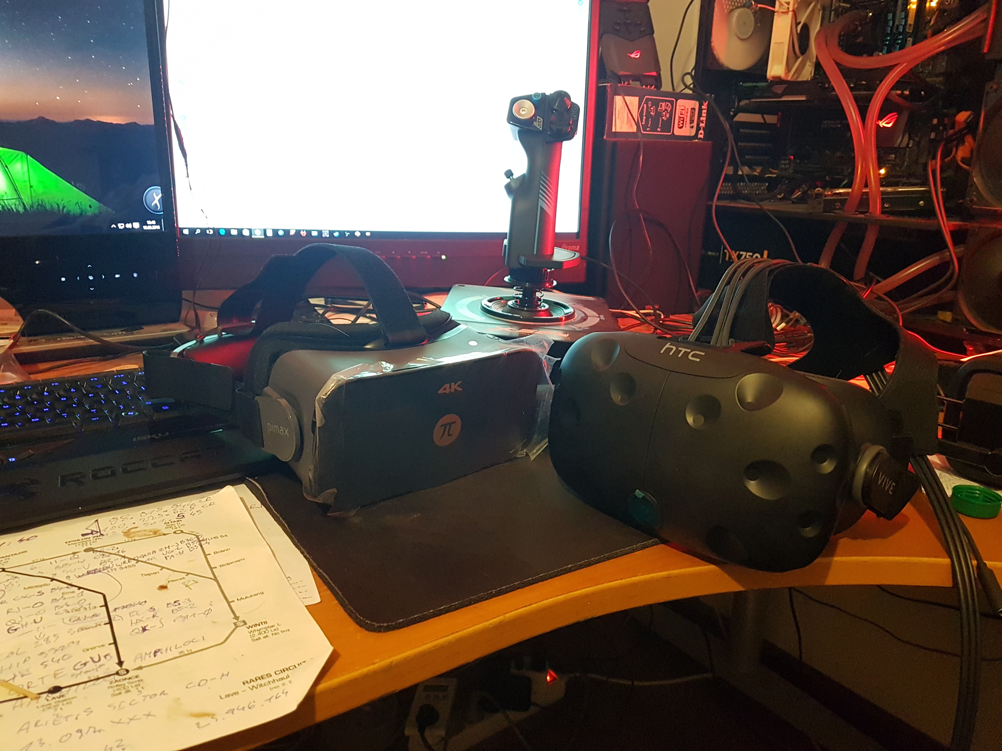

so here is my conclusion about PIMAX
before i bought pimax ive been using vive since couple months.
only ONE thing is better on that googles - resolution - twice as on vive - which could be a very big advantage if not all the disadvantages:
  • very blurry non smooth dynamic image quality - no way to tweak it somehow.
  • no option to manually set up range between lens - they made option of software make it but its not same… if u got your lens stable always in same position, moving left and right creen by soft makes finally effect veeeeery discomfortable to use - u get very heavy disconfortable “feel of brain pressure” even if u somehow make your eyes to see something quite sharp, the brain is working veeeeeeeery hard to do that and this is why its so discomfortable.
  • no option to change range betwee lens and eye -same as above but when i wear googles and pull out a little from my head to forward, it feels a liiiiittle better (im talking about that brain pressure ,but u have less field of view becouse of it.)
  • colours are flat and brightness is very low - compared do vive is like heaven and hell ;]
  • overall 3d effect becouse of that optics fact is poor. You dont get the feel of beeing inside that world of game/application that ure using…
  • plastick used as a place where your nose is going when ure wearing googles is very hard in feel. it makes your nose in pain after some time… ofc it depends from shape of your face at all but its non adaptative material and lot of ppl can feel bad in it.
  • reactions for move are fast - i cant say anything bad about it
  • but when u got bright colours on dark bacgrounds you will notice a looooot of blurr effect.
OVERALL FOR ME : im dissapointed. expected at least more comfortable of use of it. i supposed that if on GEARVR when im putting galaxy s7 into and there is 60hz too it will be same if we talk about motion blurr - on gearvr and s7 60hz it is wayyyy better than on pimax 60hz… googles are fucked up tottally by quality of the screen and no option manually set up optics at least distance between lens… more bright less motion blurr and it could be a good product but … it is not :confused:
I bought it, ive tried it, and im selling it ;] stay for some time with vive and wait exacly for next gen the same parameters like vive googles but with 4k screen and mby a little bigger fov like 140degrees or smth
