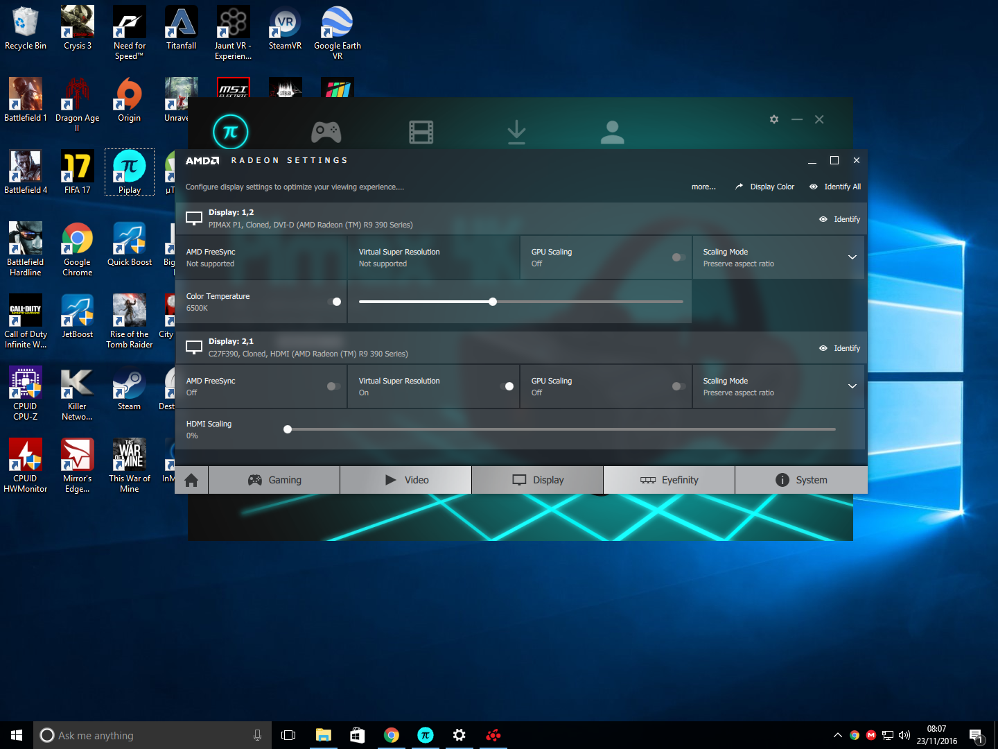

I have an AMD RX480 with the last firmware and VSR works in pimax mode.
You are not in pimax mode you are in extended mode.
I think you are right and if your main monitor is 1080p you only have access to 1080p, if it is 1440p you have access to 1440p resolution (in pimax mode).
That’s strange…i’m running a r9 390…i will try updating drivers.
im using 1080p screen but i can put the headset in 1440p without any problems.
In pimax mode, without vsr?
No i’m in extended mode,
In pimax mode there is no second screen…so your unable to change the resolution.
I’ve updated drivers to 16.11.4 and still no VSR, what AMD driver are you running?
You always can change the resolution in game and the max i can get actually is 1080p in pimax mode. If you want higher resolution you have to use vsr.

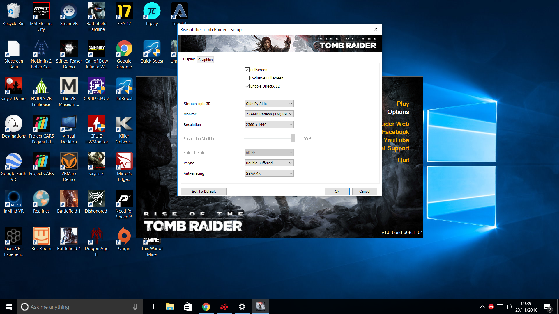

i was able to play rise of the tomb raider in 1440p in extended mode,
had to put my 1080p screen to 1440p using VSR
was hard to see the to corners and the menu…but picture looks good.
