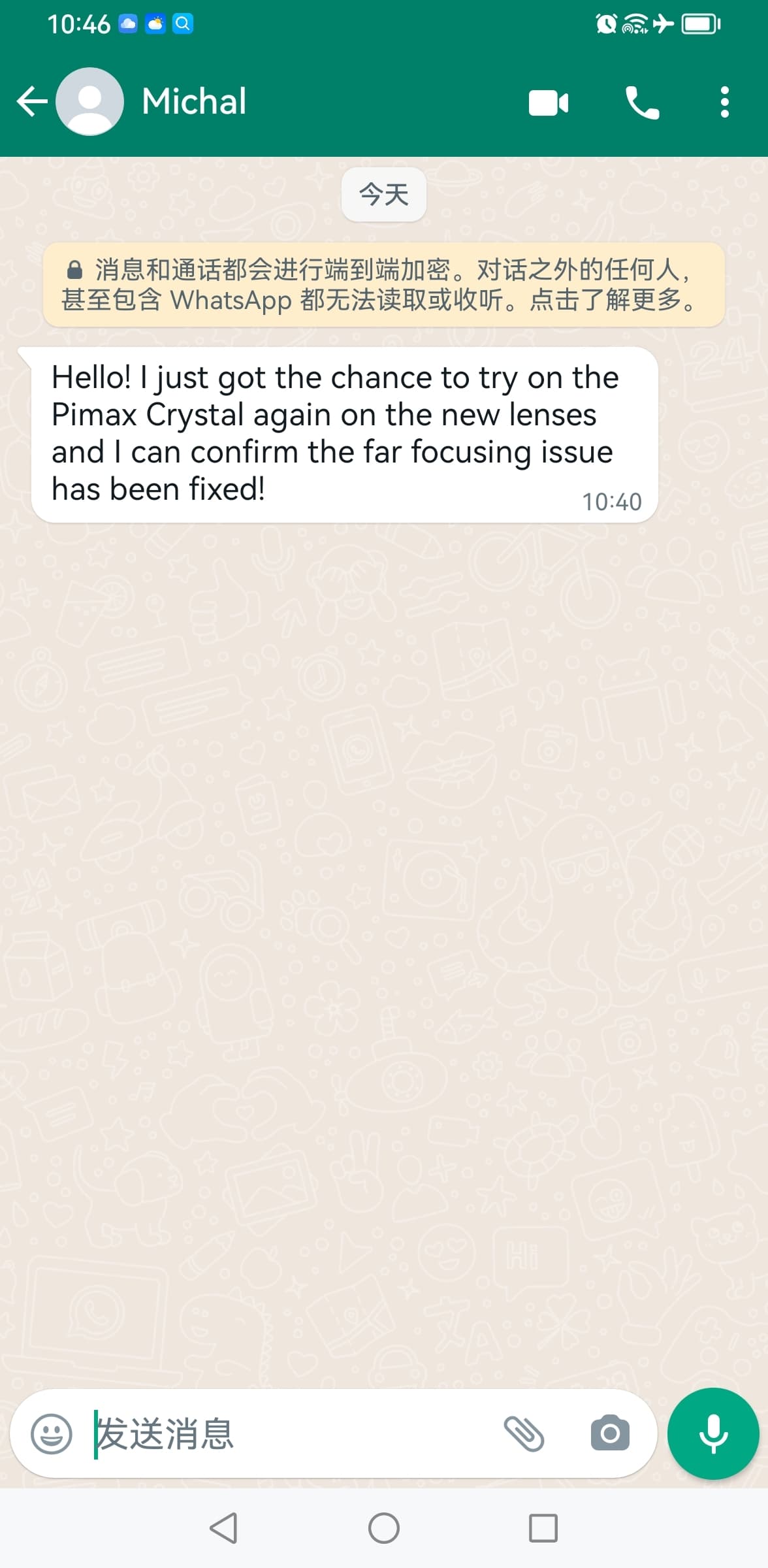

Dear Pimaxian’s,
We apologize for the experience you had when trying out the Crystal headset.
Thank you very much for your feedback on the problems encountered during your real life tests. Your feedback has helped us to identify a key design flaw and correct it. Your participation in the roadshow has been a boon to us all.
Due to the visual acuity differences between people at the roadshows we found that our internal test samples are not comprehensive enough to completely cover all problems encountered by users. We at Pimax cherish the feedback from the roadshow as it allows us to better communicate with you and listen to your opinions on our products.
In order to address the focal plane issue we have performed some comparative verifications. Our R&D team quickly confirmed the source of the issue. In our original design, due to the excessive consideration of some people with basic myopia, and with the hope of ensuring visual acuity for people with normal vision, the distance from the crystal lens to the screen was reduced by 2mm compared with the standard. Next, we will adjust the height of the lens bracket to make it more suitable the average 20/20 vision. We are already correcting the length of the lens barrel to adjust the focal plane to the standard distance.
We will use temporary solutions to improve this problem during the remainder of the US and European roadshows.
Thank you again for your support.
Pimax crystal product team

We need someone with 20/20 vision to test the lens fix. Hopefully we’ll have some reports
Just read on discord that someone who had the issue tried it after Pimax made a temprorary fix and the issue was resolved for them. They removed the 2mm magnets that were on the lens for the roadshow unit. They will be implementing a permanent fix but it seems to be a relatively easy issue to resolve
