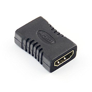

I bought a hdmi female to female adapter and usb extension, both work fine. It is possible
it workd with some cables and some female to female adapters.
i cannot tell howto define witch one work and witch dont without trying.
my expierience was that first adapter did not work, first cable and second adapter did work but there was lot of clitches in picture. now i have maybe 1.2m dvi to hdmi cable and adapter. there still are sometimes some random arifacts in picture but not too much or often.

I’ve tried to find the info for the hdmi adaptor, but I’ve lost it. I bought the cables a long way back for other things. They are only 2.5m cables I think. The adapter is just a cheap generic thing I found on amazon, very much like that one above.
I’d try shorter cables. It should work fine, mine does, you just need the right combo.
Ah I found it. It’s this one:
