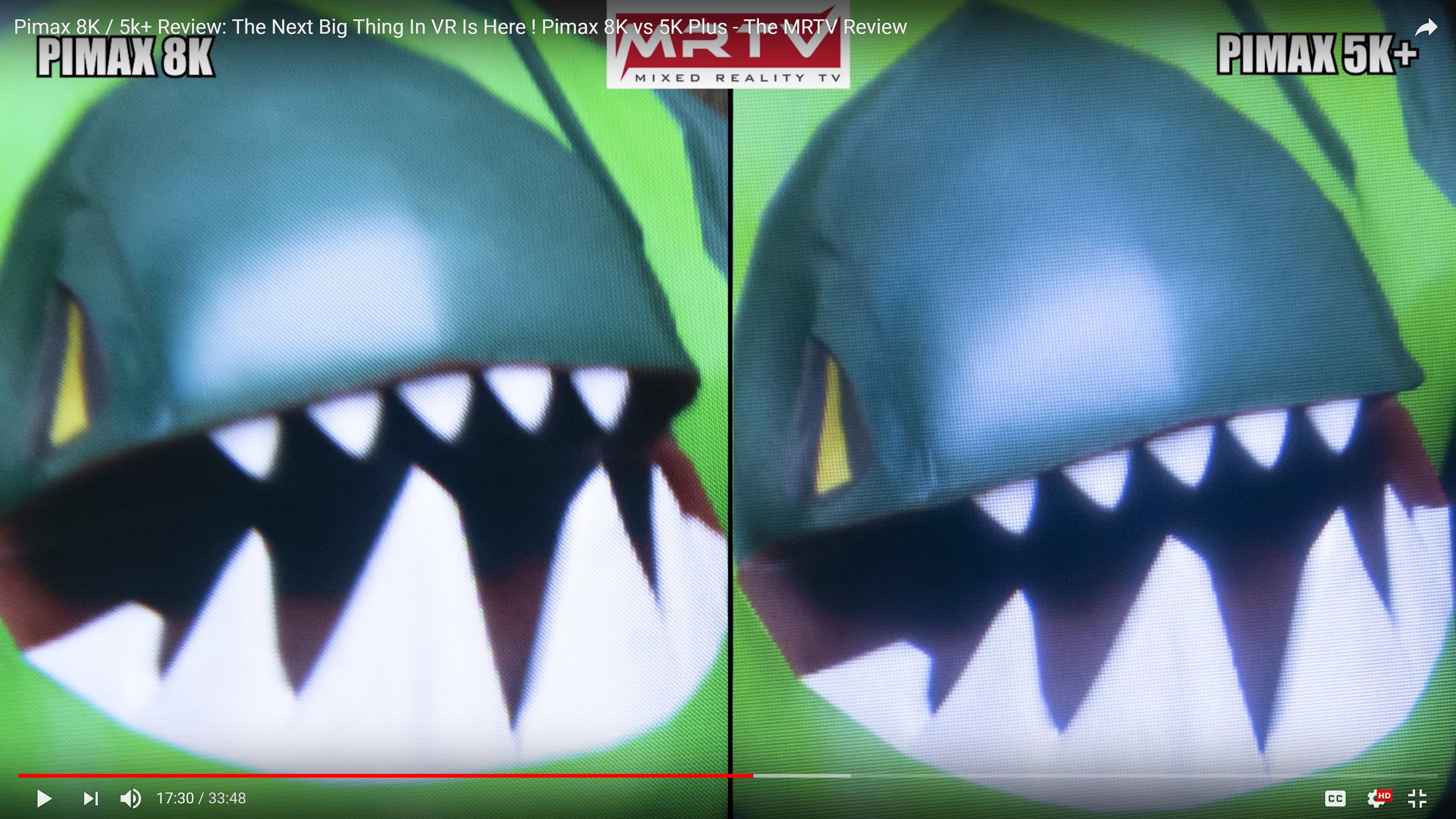

Regardless of FPS at this point, could you guys make a comparison with the 5K+ while pushing SS (both pitool and Steam) of the 8K at maximum?
Just to see the potential of the 8K regarding image quality even if not playable at the moment.
Something like this but with different SS values:

@mixedrealityTV @SweViver I would be interested about this as well. I would love to see comparison between 5k+ and 8k when you push SS to the max.
There is no comparison so that’s hard to say. All I can say is I have no issues with the, also upscaled, Pimax 4K. It does not look bad at all.
Would be great to see that comparison. And also if, and if yes, what it takes to get the 8k to the same sharpness as the 5k. For me it’s almost impossible to decide right now which to take. I don’t care if i can not run the 8k on superb quality with actual hardware @ high fps. But i would like to know, if the 8k can surpass the 5k+ witch decent hardware power in terms of picture Quality later.

Yepp, three questions would be interesting to get answered (optimally with photos)
a) how much supersampling does the 8k need until the details are on the same level as the 5k+ without supersampling?
b) how would the 5k+ look when applying the same supersampling that we applied to the 8k in step a?
c) how would 5k+ and 8k look with absurd levels of supersampling (e.g. 16x), so how do both scale?

To do this, you just need to make the same shots, but at the maximum resolution, and let it be 2-5FPS, but we’ll get at least a confirmation of better quality 8K than 5K +
Otherwise, there really is no point in supporting 8K. After all, almost everywhere 5K + looks better 8K at the moment.
Just need to make a comparison with the maximum SS, it’s easy.
I await very much from the reviewers this comparison. This will put an end to the choice between 5K and 8K.
Either 8K will be able to show us an image no worse than 5K +, or I turn to 5K +.
