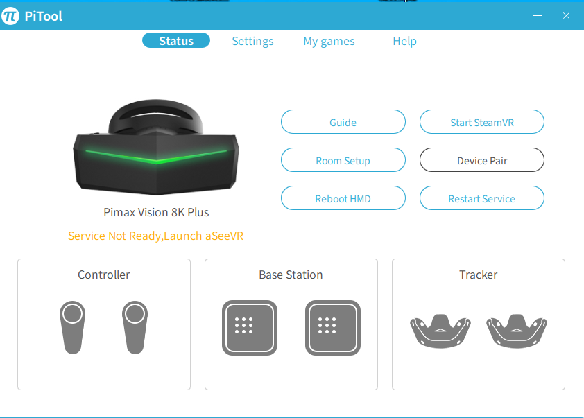

Hello,
Since today, after upgrade to PiTool .275, my 8K+ is not detected anymore. The led has a strange color, like it was both red and green at the same time (not flashing from one to the other). The led is red when I turn it off or if PiTool is closed. Diagnose says DP is not connected, but it is. Tried to switch between the DP of my monitor and the 8K+, but no change.
I tried to roll back to older PiTool versions, still the same. Updated the NVidia driver, no change.
Any help is welcome.
Thanks,
Fabrice

1 ) With Pitool 275 and last firmware : Quit pitool and downgrade with DFU (with admin rights) to firmware 270. (Check if lights blink red/green while downgrading)
1.a) If possible : create rules to block updates on firewall
2 ) After that : uninstall pitool (Clean APPDATA, Program Files), reboot, and install pitool 268. PiToolSetup_1.0.1.268.exe - Google Drive
3 ) ???
4) Relaunch pitool. It works.
