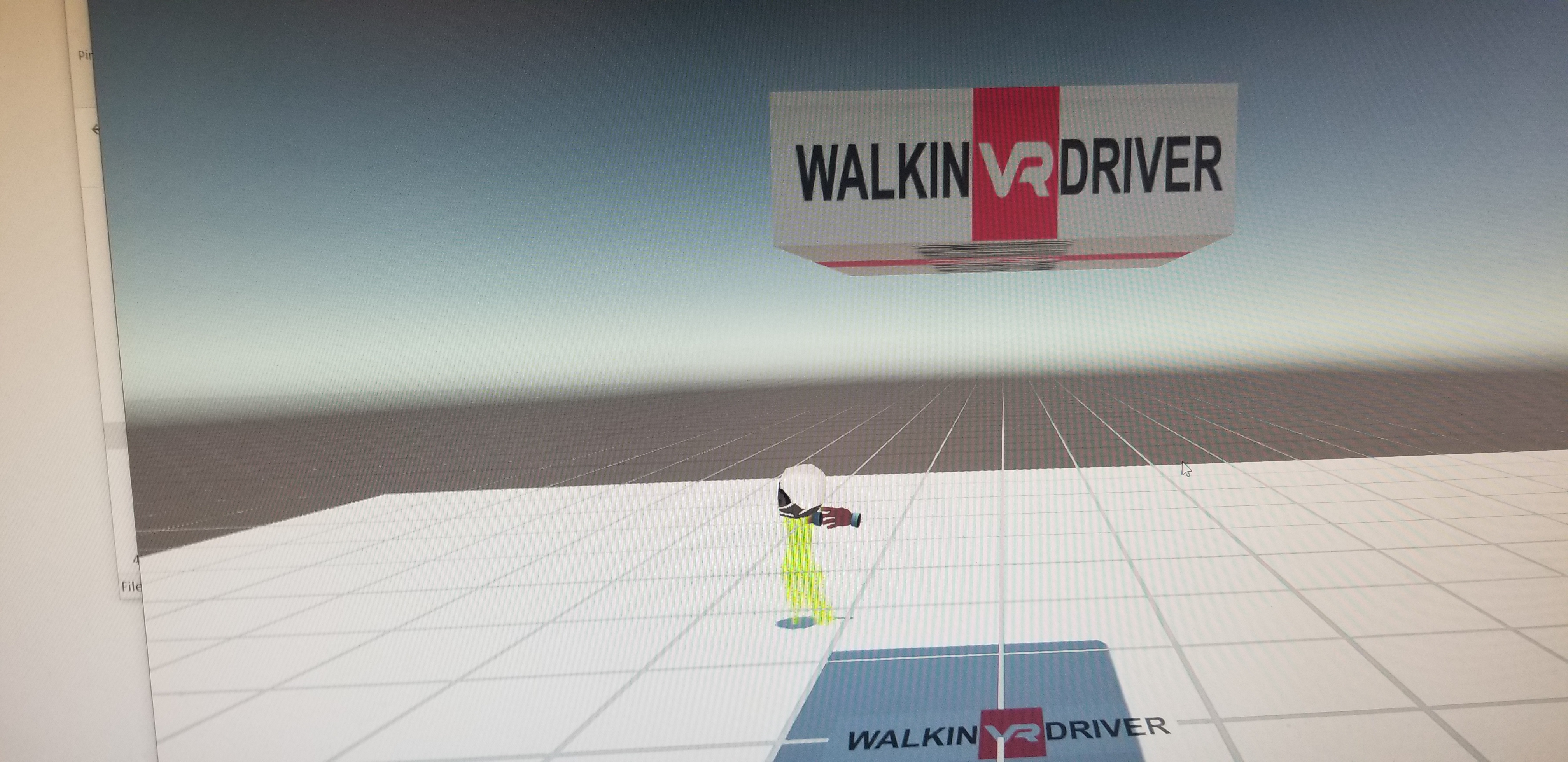

I have the same issue as u :frowning:
Our hands are there but offset
https://www.driver4vr.com/forums/topic/leap-motion-is-not-working/
At this point I think if the problem is pimax - driver4vr compatibility related , because nothing works .
Can anyone else with a pimax and a leap sensor try please ?
The leap sensor works great In pimax home . The range covers the full fov of the pimax 8k.
The problem raises when using driver4vr leap option.
I tried leap driver for steamvr and for whatever reason the range of the leap is 120 degree maybe. No idea why.

Why the pimax 8k is not working with driver4vr? @PimaxUSA :frowning:
@g-coded I would love if pimax would do with their leap motion what u just said.
In the meantime we wait for pimax leap motion module , i would be happy if pimax fix their compatibility with driver4vr.

Greg came up with this (hopefully working) temporary solution .
ā€œMarcob,
you might try temporary solutino using OpenVR-InputEmulator and play with DriverFromHead Yaw angle for each controller.ā€
