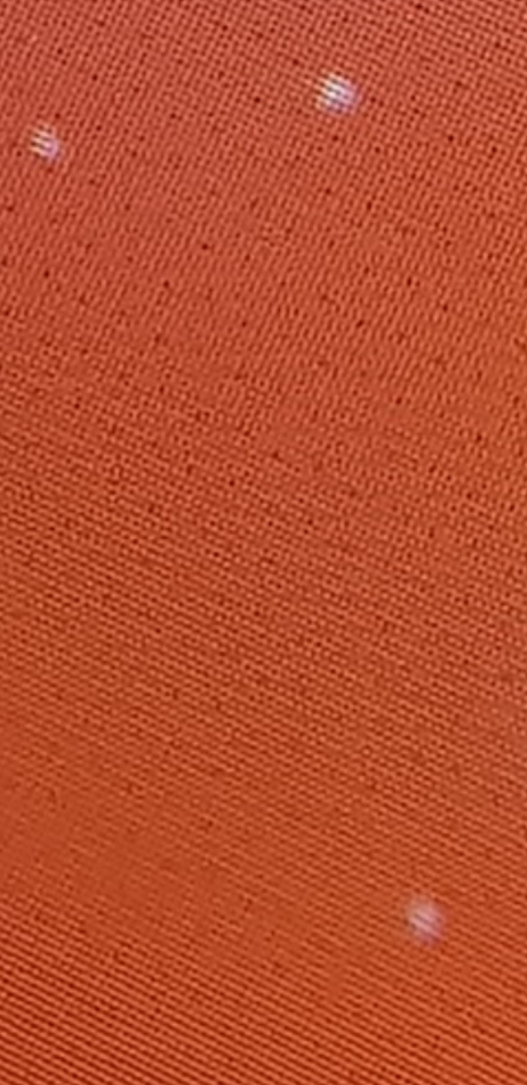

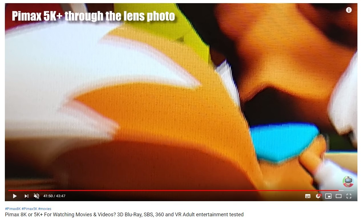

Yeah I’ll see if I can shoot some photo’s of the ‘spots’, cause I don’t think I’ve seen photo’s that do them right. I if remember correctly this is the photo that Swe uploaded but I feel that in reality it’s a bit different.
But again, please keep in mind that in most games you won’t even notice them
I found a photo posted earlier, where they showed “spots / dots”
now I understand what you mean.:slightly_smiling_face:
At first glance it seems that it is almost imperceptible …
Yeah these are pretty good photo’s of the effect, especially the last one and the blue one (2nd photo). Now imagine these dots in the last photo just a bit more noticeable in skin color and that’s what I’m talking about. It becomes a bit of an SDE like grid and I find it a bit disturbing WHEN I see them. Again, please keep in mind that most of the times in games i dont see them at all!
This is some kind of “Mura” or how this effect is called. And maybe not.
Probably, if there was no such effect, then there would be no questions to SDE at all.
As I remember, Pimax made these points for higher clarity …
But it is good that this effect is almost imperceptible.
Agreed, I think without that effect I like the SDE of the 5k+ better than the one of the Vive Pro. However in scenes where I do notice them, I think the Vive Pro is better.
