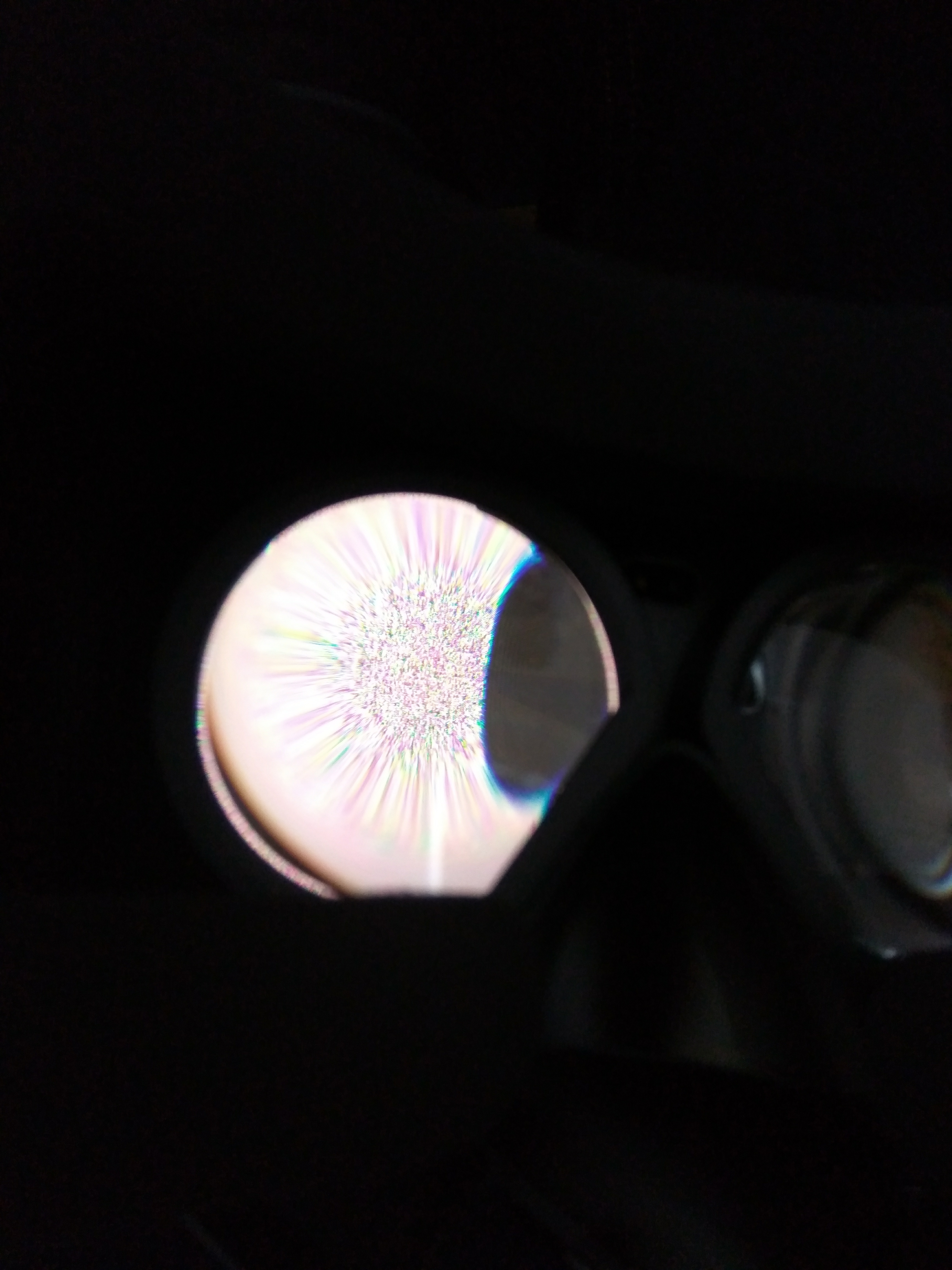

So i Guess my screen is broken but could it be a software related issue ?
Did Anyone already get this issue ?
If not i will just return it… Do i have to use the Pimax warranty or ask gearbest for a refund ?
Thanks you for your answer !

***Awesome post showing the issue & with the info you provided will help support with debugging. Just keep in mind with where they are located if they need to setup Skype session with teamview to dig deeper may take a bit to find a good time that works for both parties.
I figured it probably wasn’t the case. But provided that as a possible.
Hopefully @PIMAX-Support will be on soon to assist further. They offer some of the best in class with Skype with teamview. @LukeB has used this service multiple times.
Ok, i will wait for them but i will start to contact gearbest to prepare an exchange if nothing can repair it, i really want that headset, even after this trouble.

I hope my HMD is not broken… i have talk with the gearbest support and i will have to send the HMD from EU to China and i will have to pay the shipping costs, plus the time to send it and then the time for them to send a working one back, i will have no device for at least a month… it’s pretty disapointing for something i paid 300$ ç_ç (2 month putting money aside)
