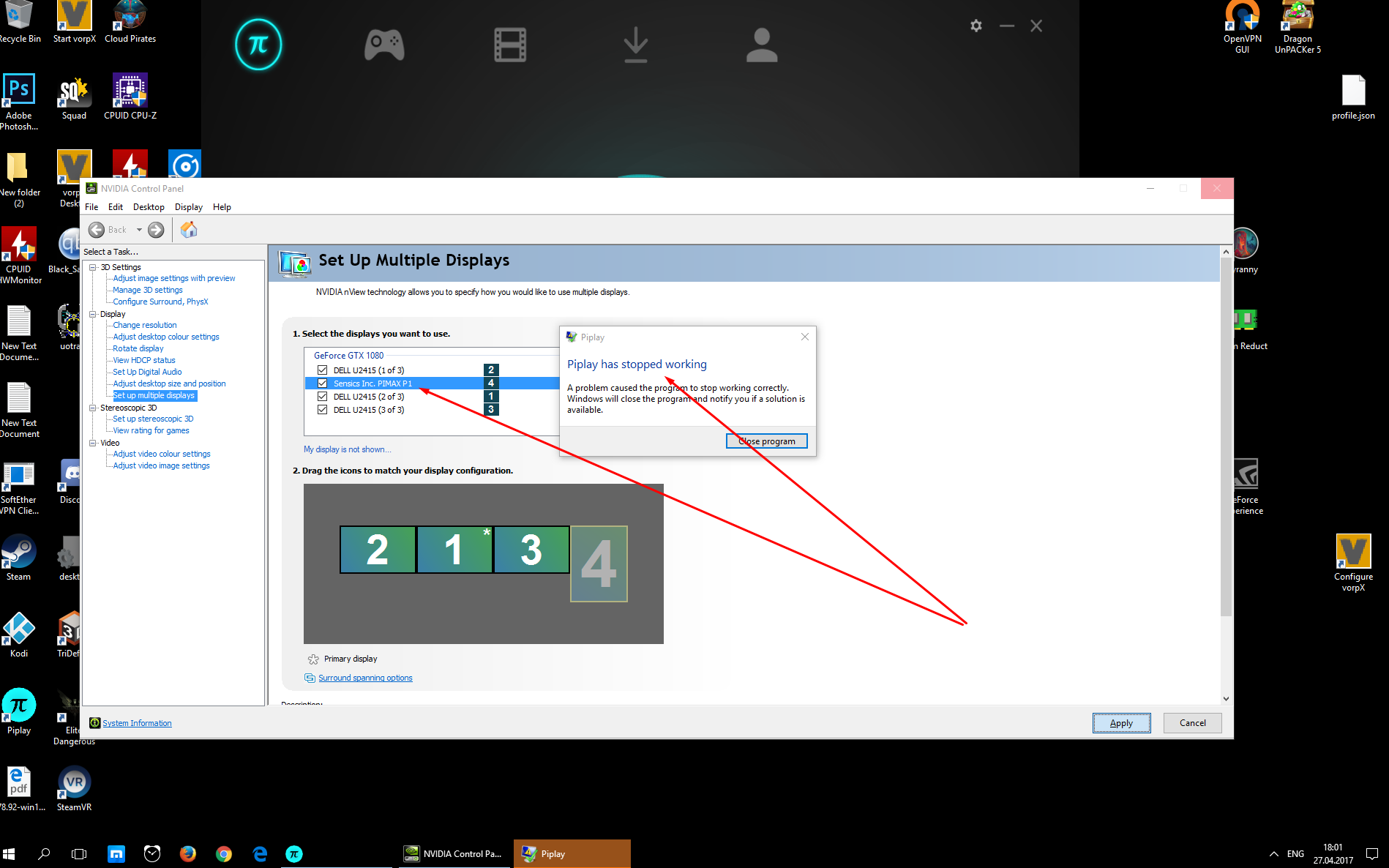

Today i have updated video drivers from nvidia to the latest build and this cause following issues:
  1. headset switched to video mode, its was in pimax before i updated/restarted my pc.
  2. pimax headset was set as primary display regarding nvidia / windows settings, i was forced to disable it in order to get all menus back to my minitor.
  3. with disabled decide pimax could not be recognized (obviously, but still)
  4. trying to enable keeps nvidia panel hanging or crashing piplay
Its the latest nvidia package that become available couple days ago.
windows 10, 1.2.63 and nvidia 381.89 driver for 1080gtx
Previous drivers worked with no issues.
update: after couple crashes i could run it, to make headset recognized i had to enable checkbox in the nvidia panel. Since it was in video mode i had to switch to pimax mod, this caused crashes too.
p.s. as for now it works, only wanted to report compatibility issues and crashes.
