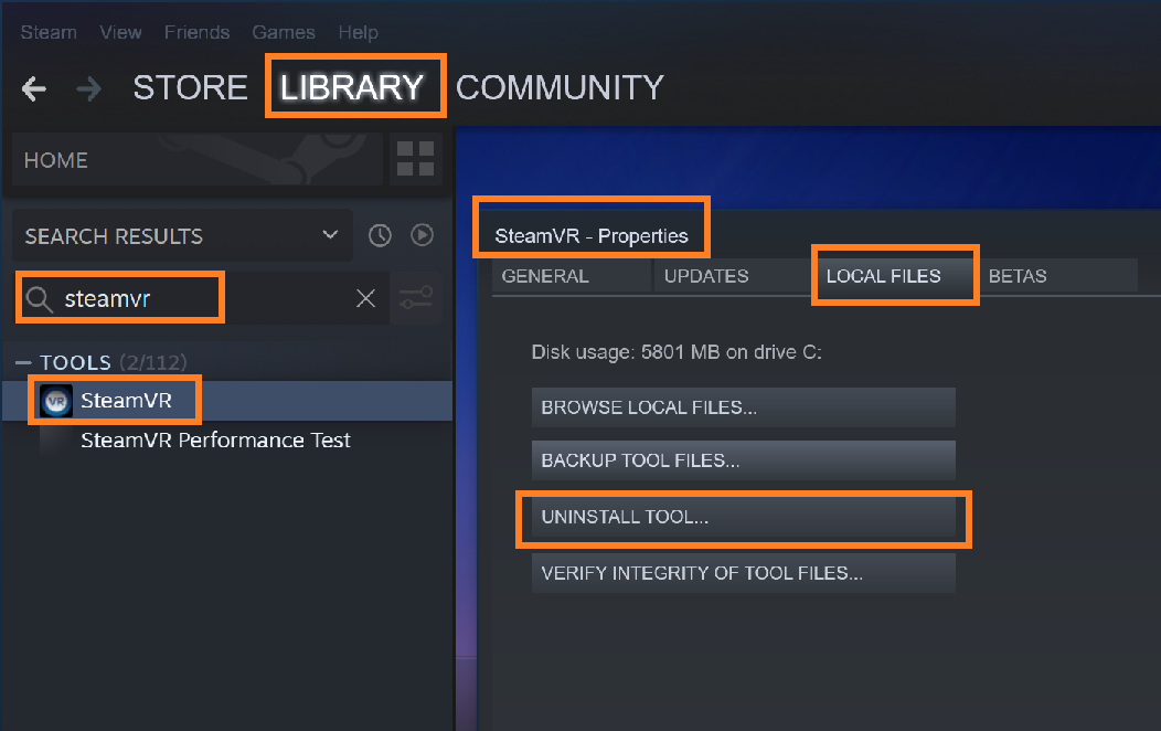

Open Steam, go to Library, search for SteamVR, right-click SteamVR, select Properties, select the Local Files tab, and click Uninstall Tool. Then when it’s done, reinstall SteamVR.

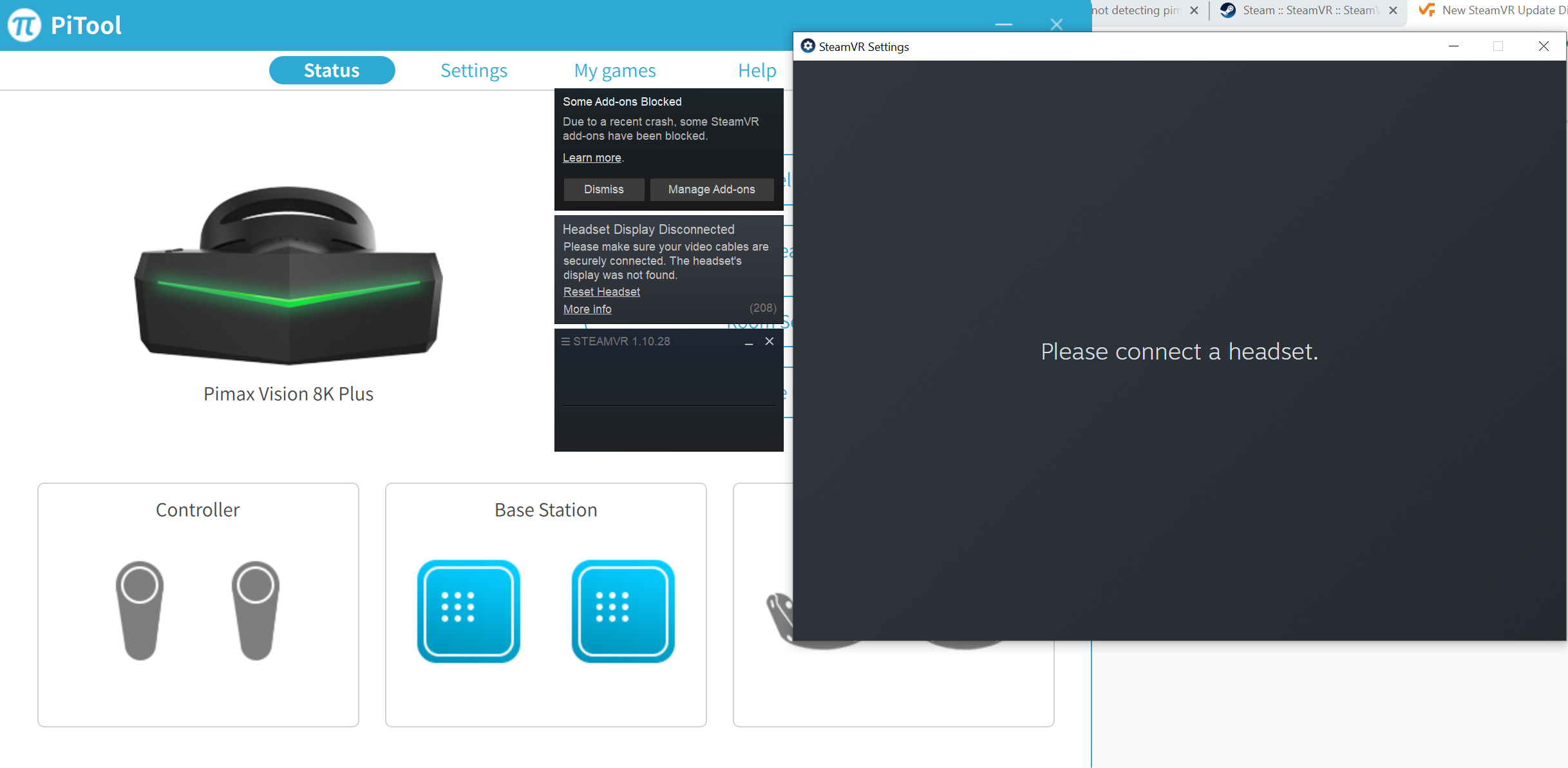

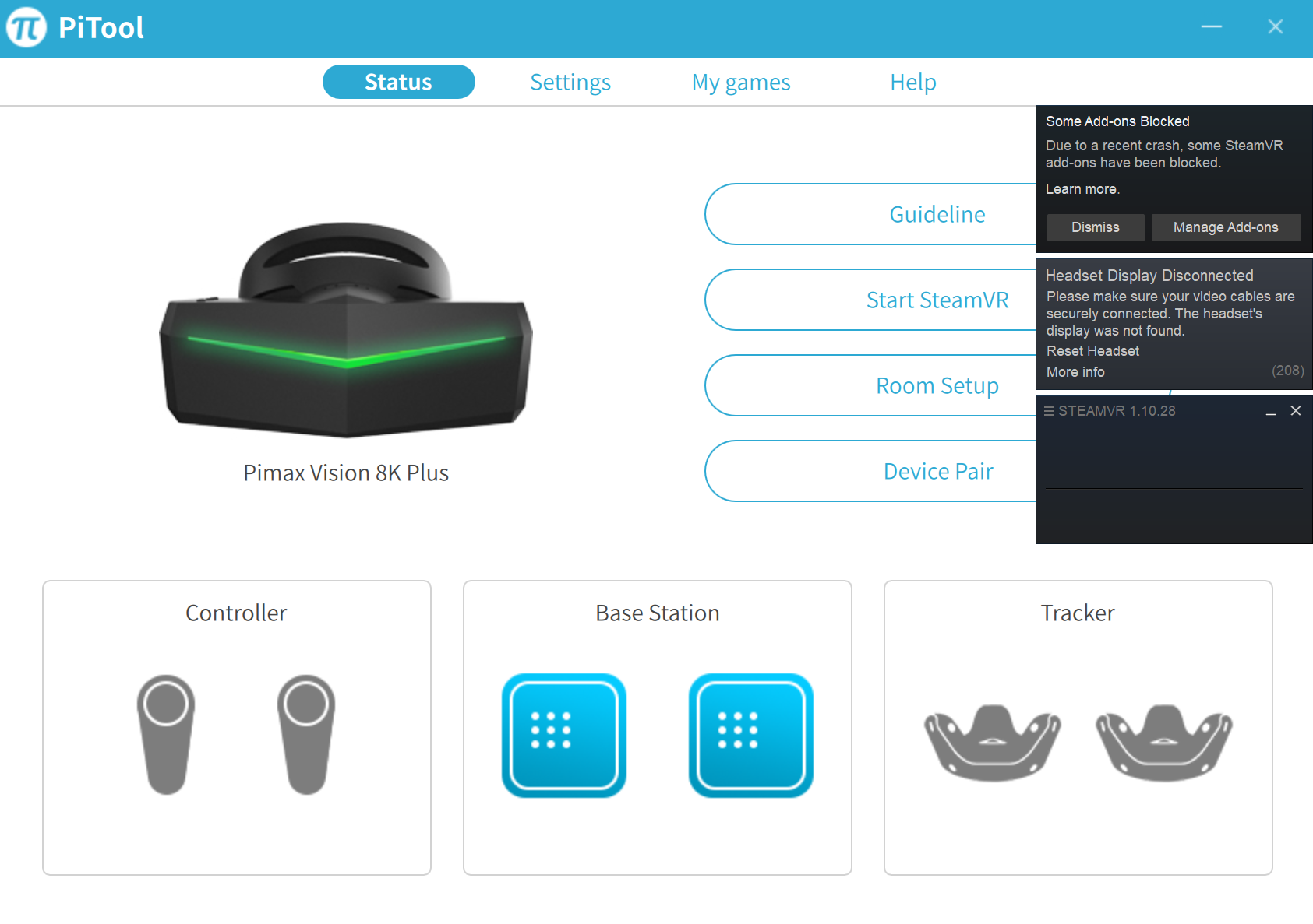

Please see below attached picture of the issue. As you can see PiTool detects my headset. I see the purple moon in the headset. And even the basestation. Except my controllers as they are not turned on.
However if you look to the right where SteamVR is, the box is empty. It doesn’t detect my Pimax 8K Plus and there’s additional error windows stating “Some add-ons blocked” and “Headset display disconnected”

PiTool and Steam VR:
