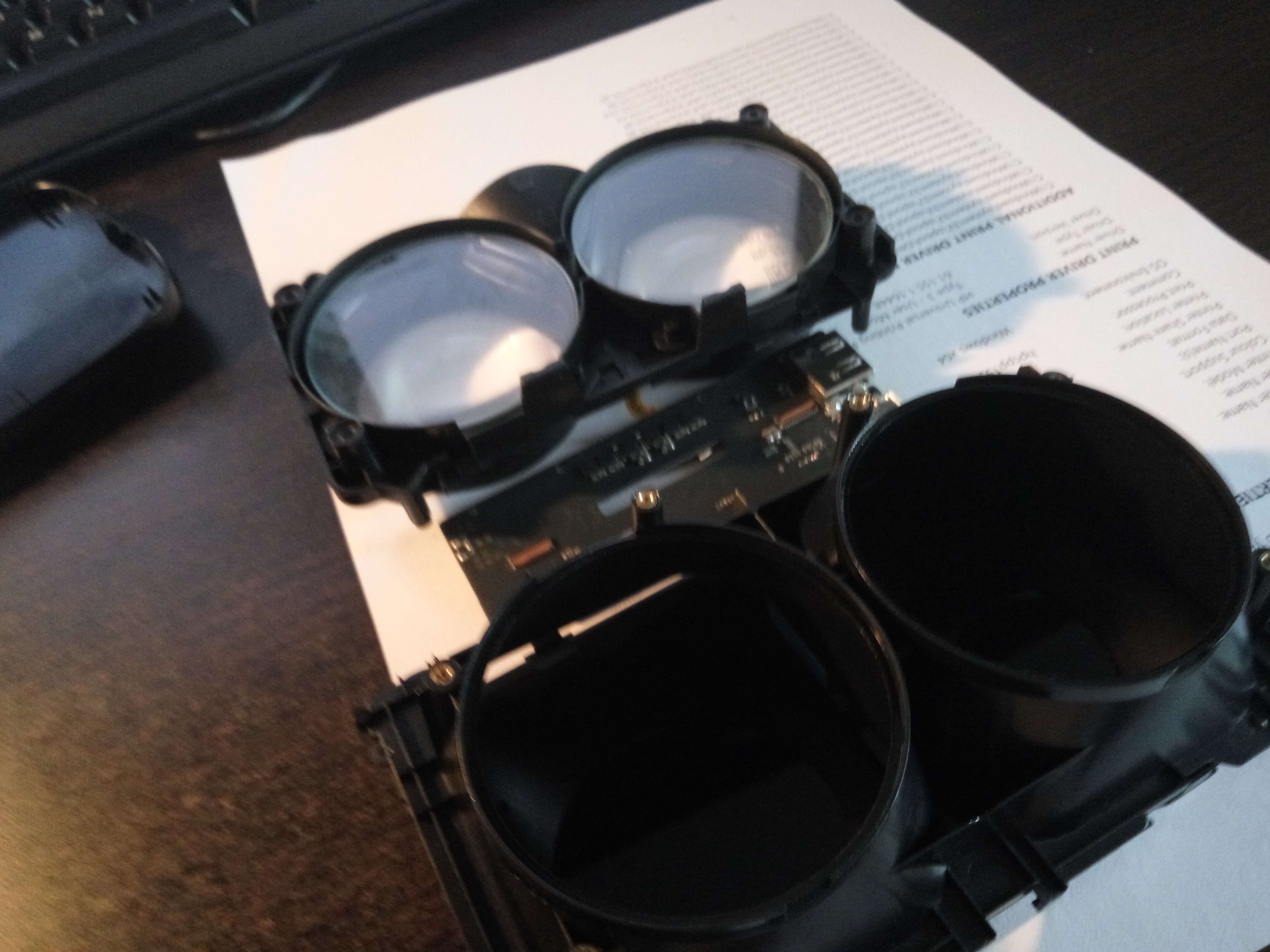

Today a dirt spot appeared on my inside left lens or on the display. So I decided to open my Pimax to clean that out, and occasionally to remove the filter glass as the above topic is talking about.
But big surprise. My Pimax 4k doesnt have any filter glass. And it is not as shinny as some people used to claim in the above topic.

Check your serial number if it starts with 102 then you have the BE edition which uses a qhd(2560x1440) oled panel. Oled does not require the filters like the 4k (serial starts with 100) uses a 4k panel that accepts 1080 & 1440 input & interpolates to 4k.
If yours is the oled; you will notice a sde but will be considerably less than vive/rift.

Been discussed a lot, if your serial starts with 102 you have an OLED 1440p panel instead of 4k. Hence no shutter glass is needed, since ghosting is better already.
Search the forum, there are return programs available to exhange it for a real 4k headset.
