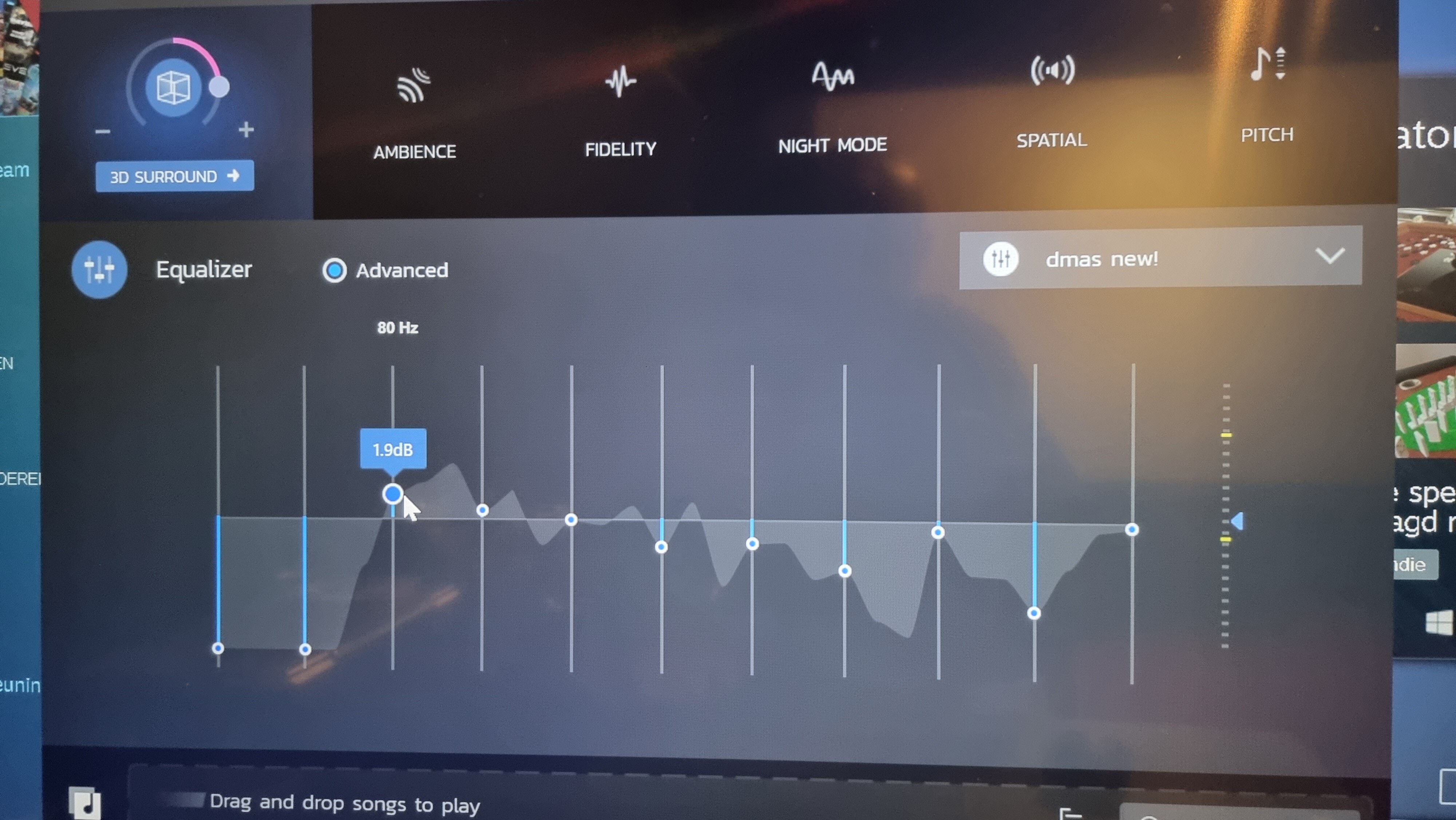

What’s your settings for the Boom 3D app?
Work your way up from these settigs…
Cool. I notice that using Spatial in Big Screen theater, it changes everything and it sound like you’re really in the theater…I think I am to go with “Spatial” for theater. Not sure about driving racing sim yet, I haven’t tested out which settings I should use.
