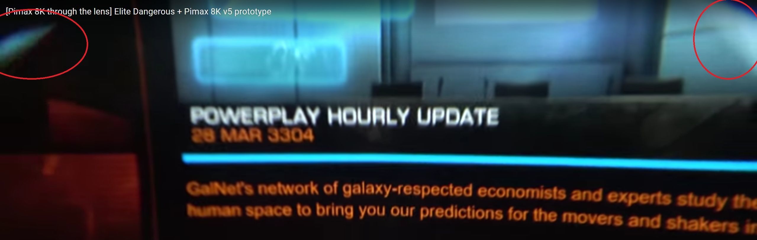

Hi,
just wanted to show the mirroring and distortion effect of the Pimax 8k V5 lenses that was shown in the Elite: Dangerous demo video clip.
I think it’s important to note, that it’s not directly at the edges, but a significant “break” within the lens itself, leading to a very noticeable band of distorted / mirroring effects.
But look for yourself:
You can see the effect both on the right and left upper corners. That means the effect affects a significant field of view.
Important: This was filmed through the lens with a camera which it’s not at the perfect spot, therefore we cannot conclude, how it will look to the human eye, when the headset is worn correctly. But it gives an indication of how the effect could look like, if the fundamental issue is not solved with the more advanced iterations of the Pimax 8k lenses.

Thanks for posting this. I hadn’t noticed that when I first viewed this video. But I do wonder if it is, as you mentioned in your caveat, a function of the camera’s distance from the lens. It does seems to come and go as the view is moved around.
One other thing I notice now in watching the video (and your lower still shot) is the kink in the curvature. Very noticeable at the word “predict” and after “current”. I wonder if that is in the game rendering or a lens/panel effect.

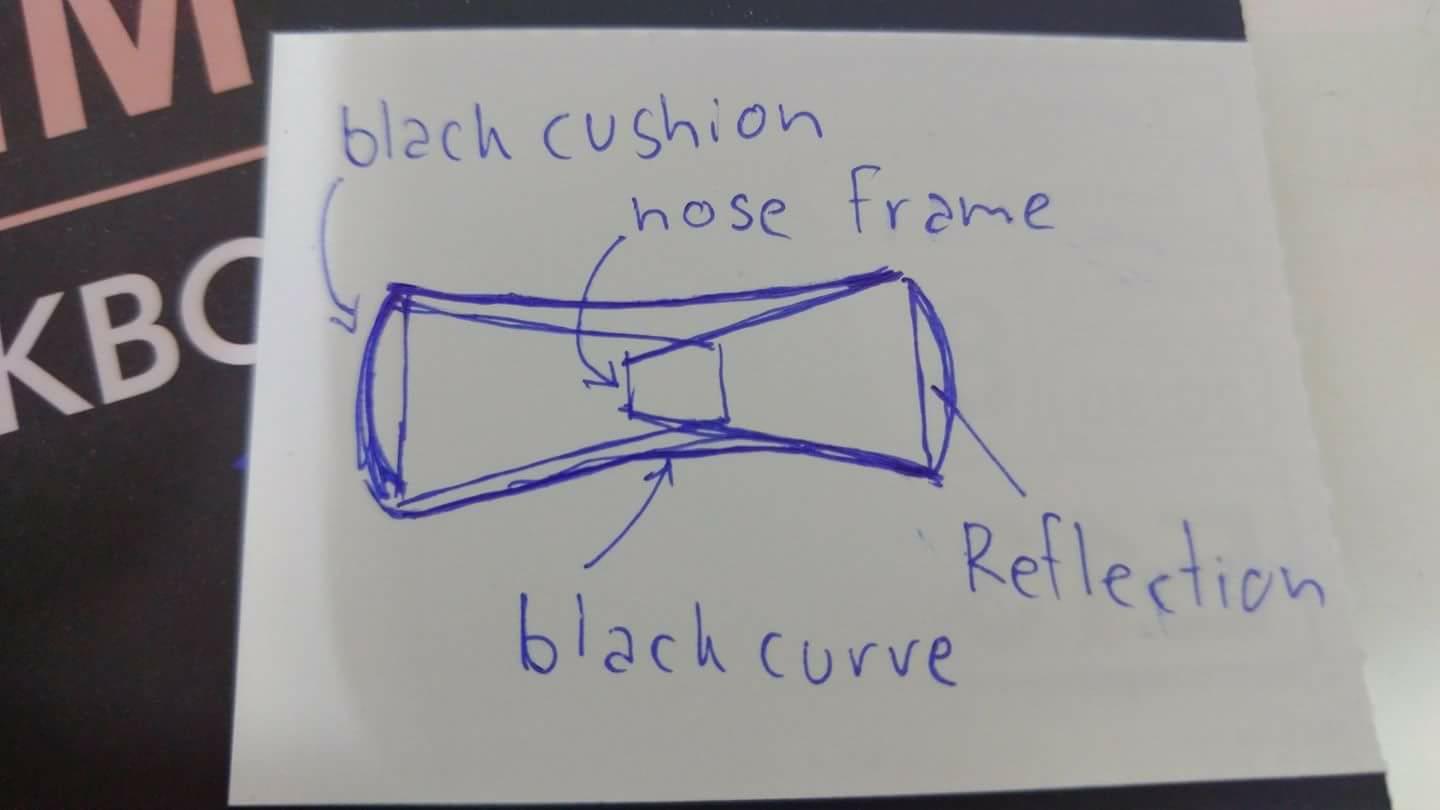

One of the reasons is the magnification change on v5. Also, v5 is the first mass production prototype, the lenses and the mechanical design of the lenses are both new tooling version. The inner face is smooth in v5, which result in reflections. We will add texture on the surface in the final version to avoid reflection.
I am thinking that may player not look closed enough to the lenses or may be we can see this when we try to look at the edge, it may be not the edge of display, but we can see this from the edge of lenses around our eyes.
