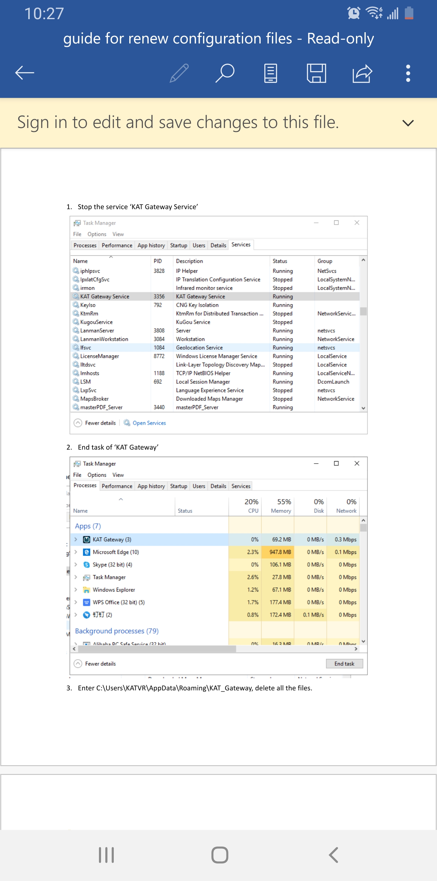

Katloco support gave me these instructions.

Followed these instructions (I only removed files in AppData\Roaming\KAT_Gateway, not Local):
Dear Christian Wilken,
Merry Christmas!
We found the configuration files in the below location are broken.
C:\Users\KATVR\AppData\Local\KAT_Gateway
Please refer to the steps below to renew them.
1.Stop the service ‘KAT Gateway Service’
2.End task of ‘KAT Gateway’
3.Enter C:\Users\KATVR\AppData\Local\KAT_Gateway, delete all the files.
4.Start the service of ‘KAT Gateway Service’ again.
5.Wait for 5 minutes, and you will send all the configuration files are renewed.
I think this problem will be solved by these steps.
Please kindly let us know if it works. Thank you.
Replace “KATVR” with Your username of course :wink:
Replied with:
That seems to have worked. Thanks! :slight_smile:
Wasn’t aware that there were config files in AppData\Local\KAT_Gateway too.

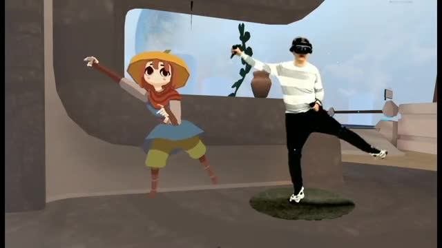

KAT loco Christmas Surprise – MOCAP System Coming SOON!
https://www.kickstarter.com/projects/katvrsolutions/kat-loco-complete-wearable-locomotion-system-walk-into-vr/posts/2718188?ref=ksr_email_backer_project_update_registered_users#asset-27583937
Yeah will have to check n see if there ready to ship as looks like mocap going to work now with 2 sets.
Seems to me like they’re just placing the “ankle sensors” on the thighs/above knees instead?
Look at the video:
And I quote:
using the MOCAP function will be possible through adoption of a new wearing method that allows KAT loco to detect and recognize pitch and roll movement of the user’s thighs
:wink:
Would mocap work only on games supporting full body tracking like vrchat?
