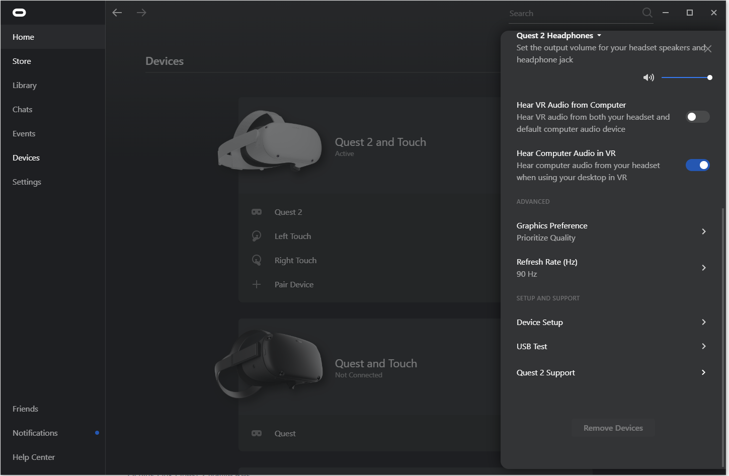

Oculus Link is officially out of Beta, supporting 90hz and I’m hoping native resolution. I’m about to hop in and test it out. For those like me who don’t have the HMD v23 update yet in the about section of the headset, I’ve linked the manual instructions for loading the update
edit: I’ve noticed the reported steamvr resolution is suuper low for some reason with this update at 90hz, but whatever. I’m going to have to compare, but I think the quality is now on par with VD, but with superior bandwidth through the debug tool. Super enjoyable, but the best part is that I’m definitely noticing waaay better performance at the same time. VD was always pretty solid, but I had some serious stuttering and lag with link especially in steamvr before this update.

They added a slider in the Oculus PC app, I think it’s in settings somewhere, you shouldn’t need to use the debug tool anymore
I’m still waiting for my v23 update, waaaaah
I had to restart the service to get that slider to show up, but i do have it now! BTW you do still want to use the debug tool to set the bandwidth higher, but just as w. encoding resolution this only needs to be applied once and it sticks, not every single time like with supersampling. I really wish they integrated reprojection settings into the oculus app. I can’t stand space warp, and I don’t know how anyone can tolerate it honestly, though I know I’m not in the majority with that opinion.
