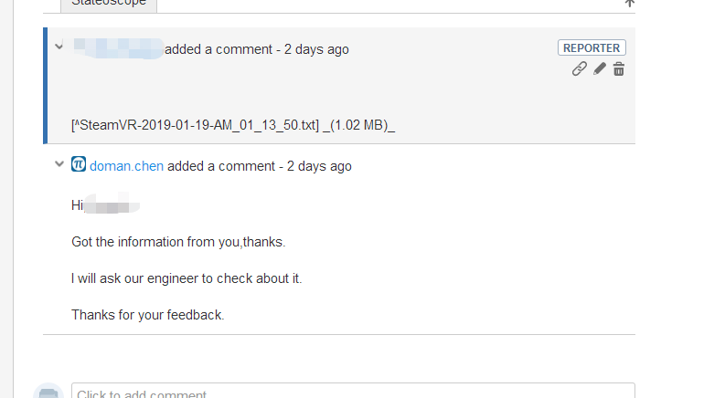

@anon74848233
raised ticket ā€˜1. SUPEN-1287’
thanks
Eno
Thanks… Will wait for reply
