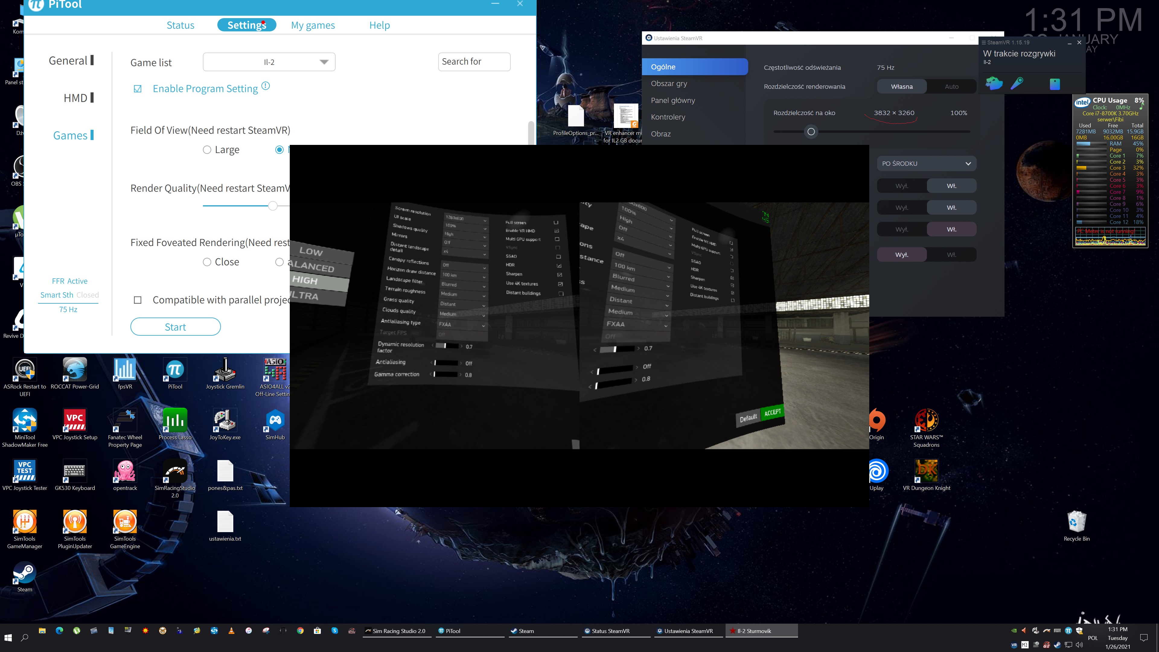

You dont need to converting zoom with VREM mod. IL2 is supporting “zoom” convergence in game without need for “PP on” since latest patch.
I’m using VREM only for better colors and saturation adjustment but some well know MP servers will not pass you with this mod.
PT Colors:
Blue: Sat +3 , Brightnes -3
Red : +2 , -2
Green +2 ,-2
Backlight 70 %
Note: that in my case FFR conservative is working OK but for most ppl dont.
