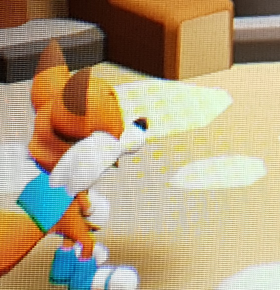

I did find this from Sweviver’s 5k+ pic
i just cropped it. Are the yellow smudges like what you meant?
The only time I turn them on is when I’m getting a neutron star boost. That’s quite often at the moment, since I’m headed towards the galactic core. I find the color fringes to be highly annoying, which is one of the reasons I considered getting the 5K+. However, the larger visible pixels on the 5K+ would probably bother me too, so I’m OK with my choice of headsets.
So you don’t have the colorfringing on the dashboard? Maybe it is because of the fine lines then. I will check also when my 8k finally arrives, but a photo is interesting to see if you can do it :slight_smile:
Sounds like the 8K has the same issue as the 5K. 1px horizontal or vertical lines are shifting colors.
