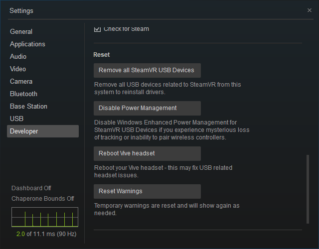

Another possible solution that can work I found after experiencing loss of tracking of the hmd and controllers after a Windows 10 update is to disable windows usb power management. It is simple and effective if related to a usb issue. Go into steamvr settings under developer you will find a disable windows usb power management setting. Once selected it just requires a reboot of steamvr worked immediately in my situation. Maybe worth a try if you have a similar experience of loss of tracking or device disconnecting.

I remember that my friend ever found wmr problem about black display although it still be moving the game on monitor. They solve by tick out the “Allow the computer to turn off this device to save the power” in power management tab of the properties of the headset in device manager, other usb too and this issue relate to pc. Similar problem.
Today I start my pc, I turn on switch of headset and base station.
The hmd is not connect again.
Then I start steamvr in Pitool although the headset still not be connected. After that I try to disable power management.
And close the steamvr, the HMD is connect automatically.
Then I try to turn off headset and turn on, it fine.
Good job!!.
I test to restart and headset automatically connected, great.

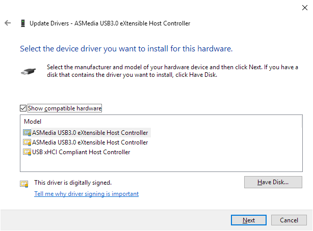

So I try to check the Device manager about usb, I found that there is one usb has alert icon. So I update the driver and then the headset connected again.
When I use samsung odssey, I found this issue for a lot of time about headset is not connect. I found that my Asus mainboard has some issue and I have to change to use other driver instead.
Samsung Odssey use USB xHCI for headset.
But I think I have to use another driver for pimax.
And now I can turn on and turn off without problem.
