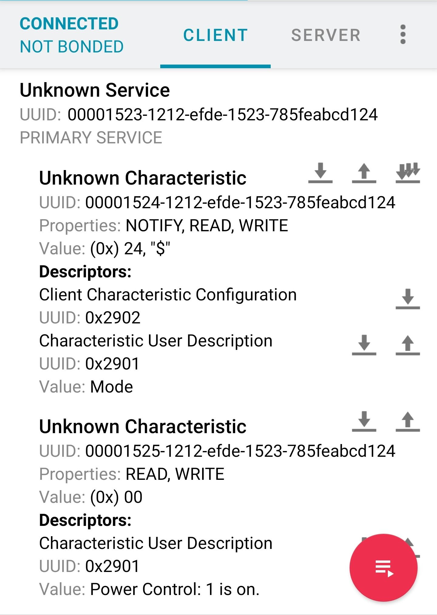

Just to add some additional info based on the lighthouses I got from Pimax in my backer box just now (https://community.openmr.ai/t/just-got-the-backer-box-with-two-lighthouses/32906). Which seem to be running an archaic firmware and probably an older version of hardware:
The characteristic mentioned above is advertised as Read/Write:
00001525-1212-efde-1523-785feabcd124
Properties: READ, WRITE
Parsed value: (0x) 00
Raw value: (0x) 00
and at the beginning it seems to have some random value, but writing 0, turns off the lighthouse and writing 1 turns it back on. Once written reading from it returns the written value. Interestingly enough this characteristic is explained as “power control: 1 is on”. Which makes sense :slight_smile:
The other characteristic is explained as “Mode” and I have suspicion that this could indicate the channel number, but reading it gives some unrelated value (e.g. 0x24).
This is not present on 2001 firmware apparently. I am going to upgrade the firmware once I get hands on Valve’s headset and see how this changes the behavior. The good news is, out of the box, it is possible to power control the bases just fine.
