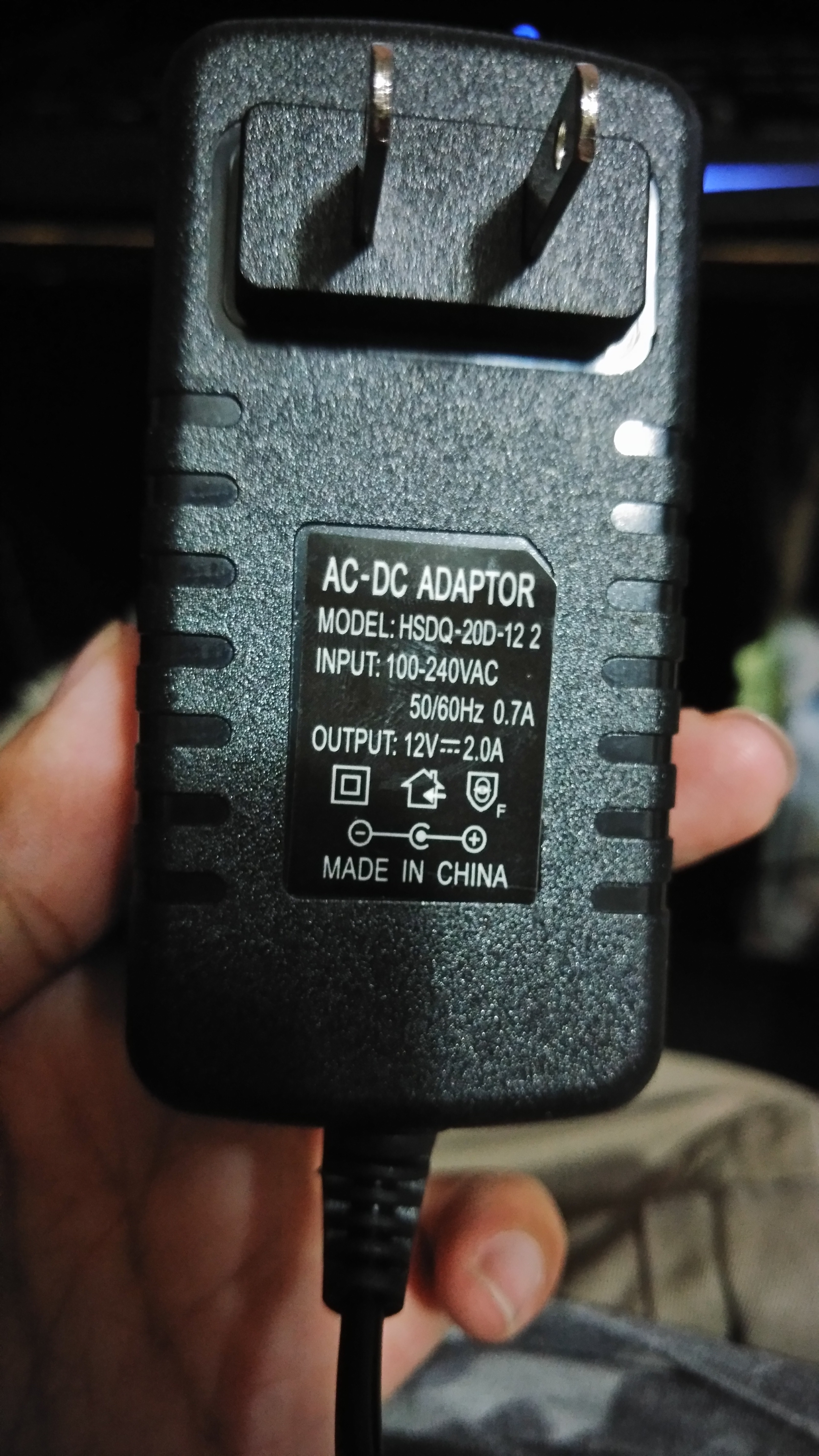

Yeah, a little different from VIVE linkbox.
You could look for the adapter by yourself as below:
Power:12V2A
DC plug size: 3.5X1.35X9.5mm
Type:Tuning fork card ditch
size is correct? Has sample on aliexpress? thank.
okay see it now
Already order on online shopping, will test and feedback soon.
@park @Sean.Huang
Already test, this can’t solve the issue (little better), I notice that it is only 50/60Hz 0.7A while other is higher. So I will test the old cable and power adapter of old headset next week.

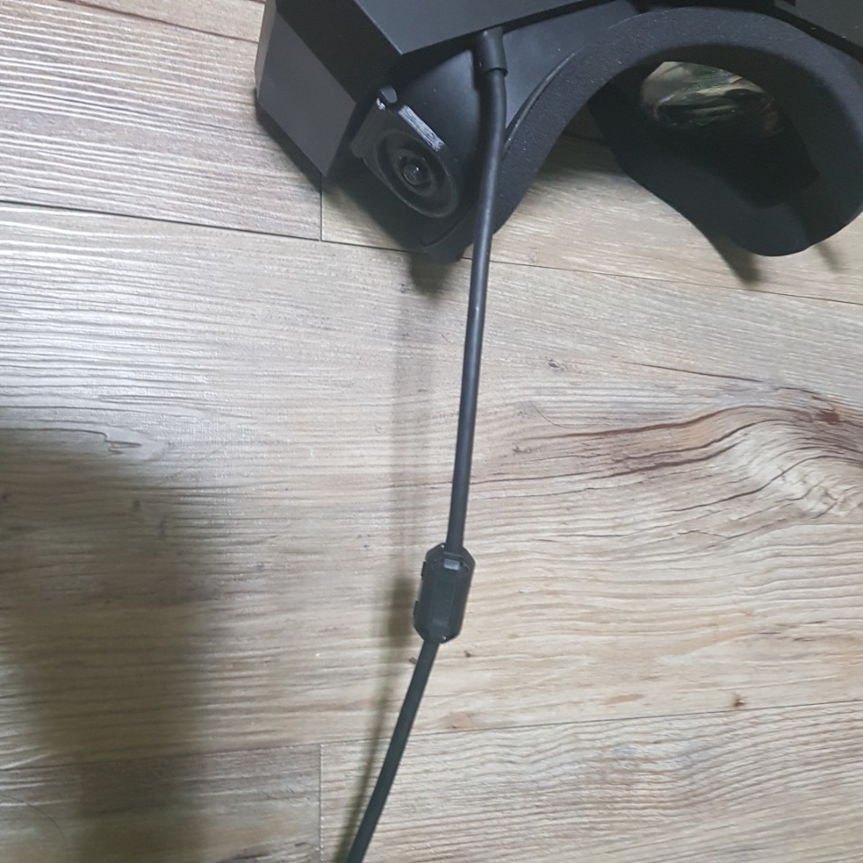

Noise filters can help you.

https://www.aliexpress.com/wholesale?catId=0&initiative_id=SB_20190118173859&SearchText=ferrite+core
It’s easy to buy in the online market.

Dallas the pic he has posted is to show the Emi RF filter. These clip on filters reduce potential interference that may cause the flickering dots some have posted.
Having these pre installed on the headset cable may reduce rma as a result as many will not know this tip that @park has posted.

@Alan.sun The adapter help headset fix the white dot issue.

It is very easy to buy in Korea. You will be able to buy it easily in your country.
The problem isn’t completely solved, but it’s very hard to find the white spot.
it’s 7mm.

In Korea, this issue has been improved because one person has changed the power adapter, and one person has added the ferrite core. I hope that the pimax will resolve this issue quickly.
power adapter replacement,
ferrite core Install…
