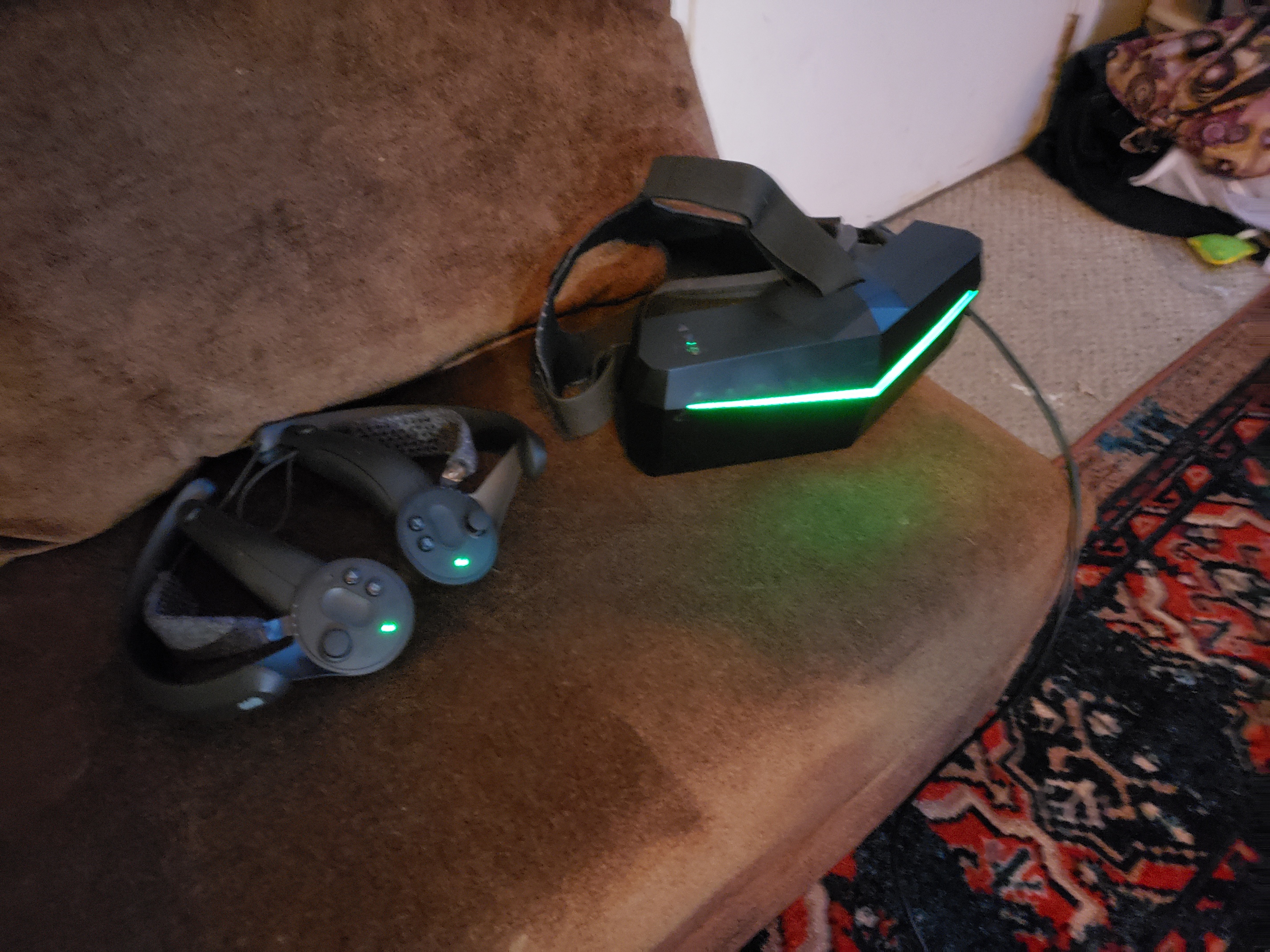

I decided to give another try. Using a single base station. Base station is on a nice solid surface in front of the TV set facing the couch. Both controllers and base station are solid on in pitools. But it still says head set not tracking, and won’t let me do the room setup.
And I tried walking the head set up to the base station and rotating the headset in front of it and everything. And yes I took the protective plastic of the base station before anything hehe

My last post is the current situation. Using only one base station, the base station and controllers are solid on in PiTool but the HMD still says not tracking and won’t let me do the room setup. In STEAM VR it says can’t find HMD. If I have "lighthouse tracking OFF in PiTool then steam vr does recognize the HMD but without tracking of course.
