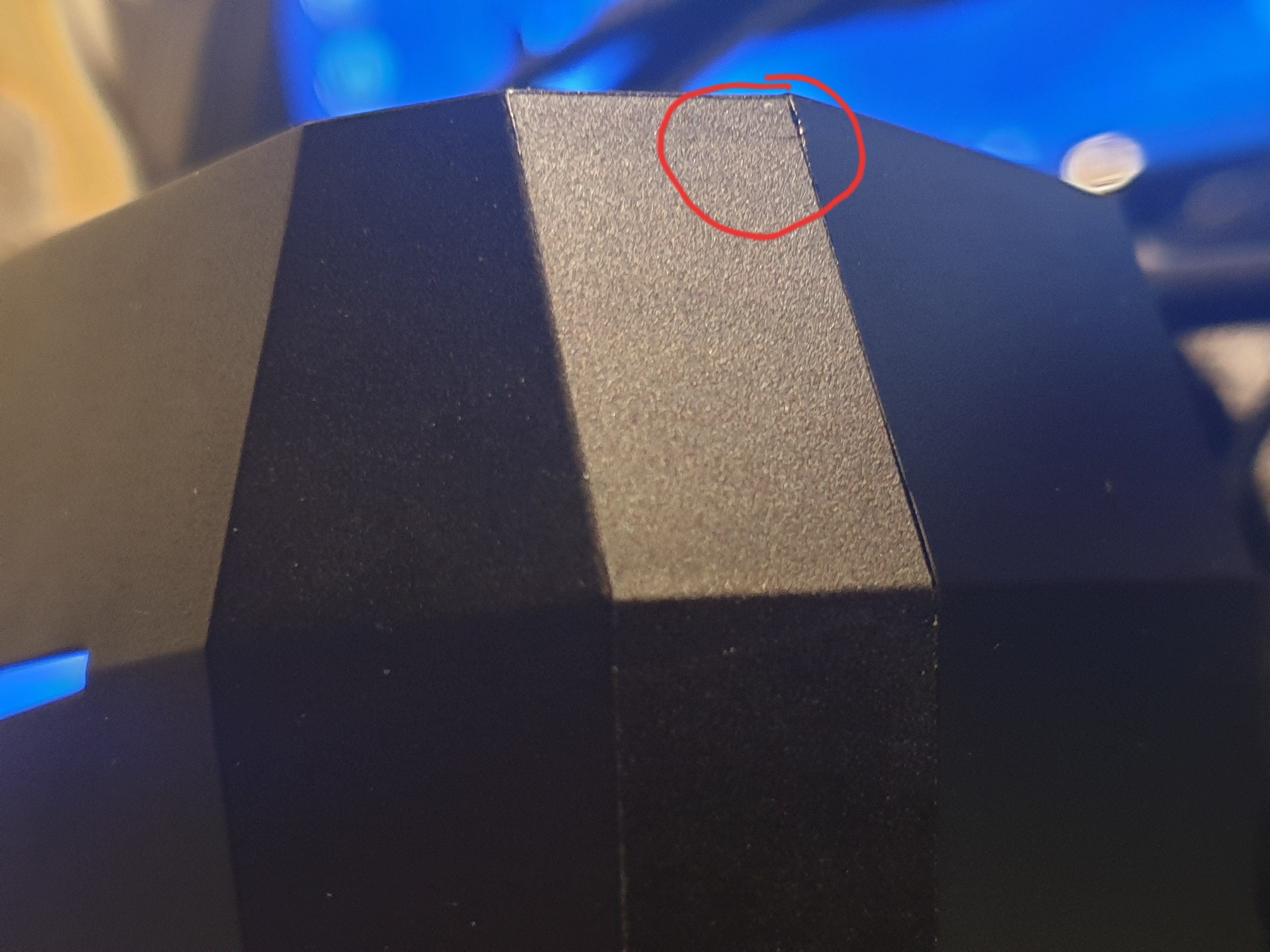

Housing Issue Reports (cracks, imperfections etc.)
Thanks I’ll contact support then… not a big deal but the “autocracking” of that plastic makes me think that problems are just around the corner… not too happy

All housings seem to be cracking.
I have now got my FOURTH Pimax 5k +.
Yes you read correctly: MY FOURTH PIMAX
After only 3 days, the first cracks come!
Is is really incredible!
I am very angry about it.
We pay so much money and get scrap.
It is so sad.
Technically she is very good. The case is garbage!

Same issue, I’ve had 4 x HMD’s now, each replacing the last. ALL have had cracks including the latest replacement after about 1h of use.
I explicitly asked them not to replace if they haven’t solved the issue, I was assured it was solved.
The results speak for themselves and I know I’m not the only one.
Extremely disappointing.

It was clear from the beginning (to me at least) that the design+plastic thickness/quality was bad. No fine tuning the manufacturing process would’ve saved it. And didn’t, actually.
Edit. I’ll say something nice, so I won’t get banned.
The Pimax headset is a bit like Tesla cars: quality is crap, but it’s still kinda futuristic and cool.
It’s not clear (to me) that the problem is the plastic thickness/quality. Supposedly, it is an expensive grade of plastic (but who knows if that is actually true).
I think the problem is that the design for the entire front piece requires an infrared-transparent plastic, which imposes serious limitations in options. It’s brittle, so adding more thickness isn’t necessarily going to help (and will reduce the sensor sensitivity). I’ve had several TV remotes where the IR window has shattered (due to being repeatedly dropped) and the plastic was MUCH thicker than the Pimax headset.
An (imo ugly) design like the Vive (with IR windows) is a much sturdier product.
If Pimax wants to keep the current design aesthetic (which I really like), they may need to go with a 2-layer approach and bond a studier plastic to the inner surface, leaving windows for the IR sensors.

Apart from apologizing, I don’t know how to start explaining such a special situation.
As I told you before, we got it by testing and analyzing the failure of the cracking. Indeed, the biggest reason is the production process, the material itself does not have the problem of cracking. We have fine-tuned the internal structure of four angles through the improvement of production technology and almost eliminated this problem.
Back to the point, the company attaches great importance to your cases. We cannot tolerate such quality problems. Because no company would accept such a thing. Moreover, there have been the third time RMA and there are still quality problems.
As for Paul’s case, we already know your ticket. We will analyze your previous case. We also need your fault headset to analyze the cause and determine its production batch. If there are still have headsets in the same batch in overseas warehouses at present, we will recall them and analyze them.
For Timo’s case, please tell me the ticket number or SUPEN number you submitted. We will also analyze the cases you submitted before and the fault headset you received.
UPS China service will open tomorrow or the day after tomorrow. I will send a return label to both of you immediately after the service opening and send the fault headset directly back to Shanghai. I will inform you of the results after analysis.
In order to ensure the machine quality of future replacement, we will suspend the shipment of overseas warehouses. Starting next month, all RMA headset will be sent directly from Shanghai.
We apologize for the inconvenience caused by the previous the third time RMA.
