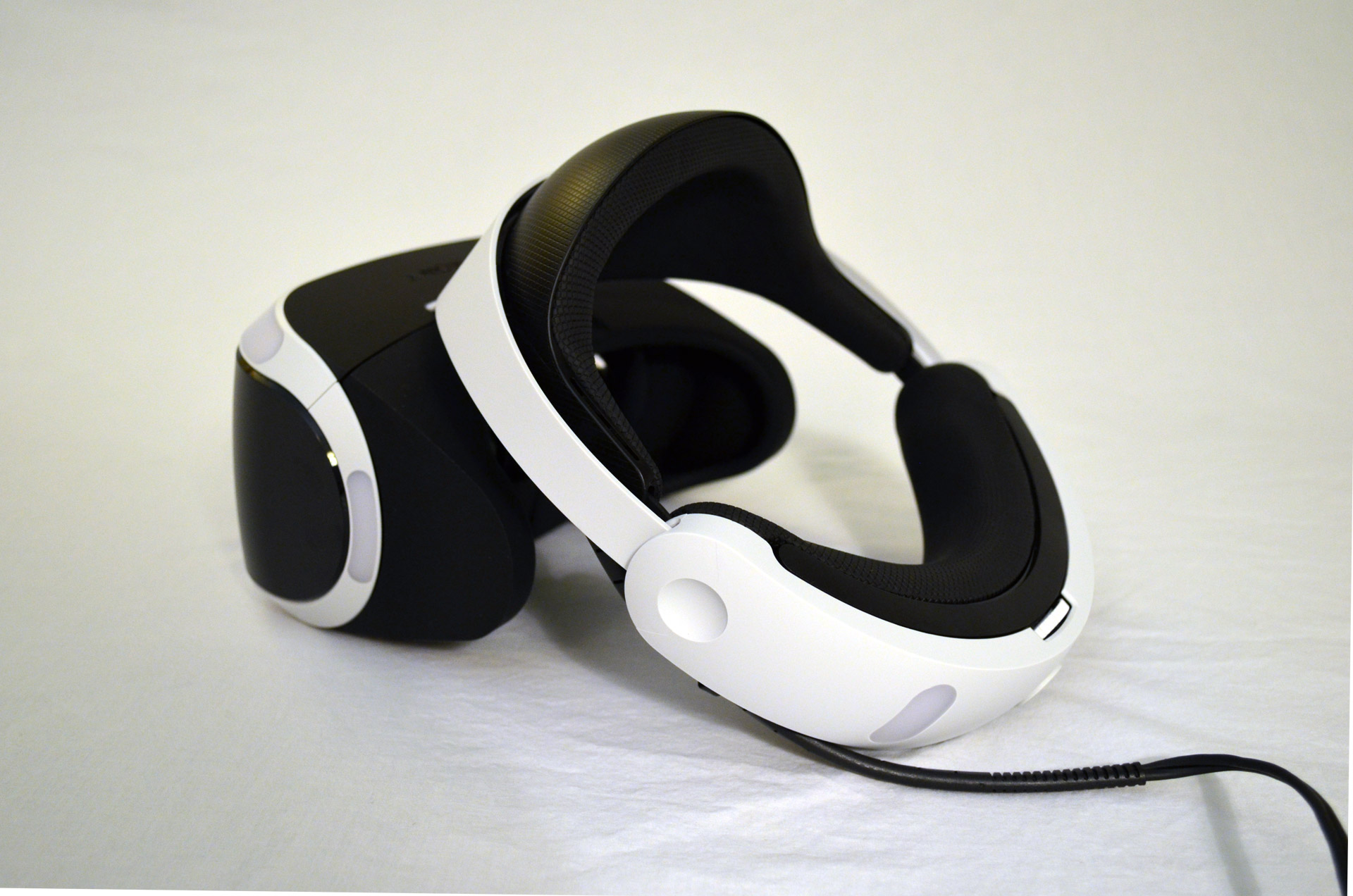

Headstrap like PSVR is “required” to correct edge distortions
Today I tried 5K+ with some friends, because one of them received it.
At first, for me, was awful. Everything with a high distortion. But they said that they can see everything ok…
My IPD is 69mm, and they have 61-62. Then I tried to move away a little the HMd from my face, with my fingers, and all start to works perfectly.
Then… I notice that if the HMD lay over my face, without pressure, the distortion disappeared.
I tried an Odyssey+ cover, because it is thicker, and it works too, but I lost FOV. And it’s painful in the face.
And this is the main reason why some people can see distortion.
When will we have the PSVR like headstrap? Because I think that people with big IPD or specific face… we won’t be able to use Pimax HMD until we have it.
Thanks in advance for the answer @anon74848233

Not sure about license, but I like move in and move out function of psvr too.
Exactly, the pull in and out feature is what the OD is missing.

@Yen - I was thinking exactly the same thing days ago after using my new Od+ for the first time, I have both PS-VR and Od+ , and the first is the only headset I know of that lets you have a perfect distance in respect to the headset, I don’t get why this system is not adopted on other headsets too, it is so simple…
Plus , the lens Sony is using are very good and clear, almost better than any other headset and brand.
VR companies should learn a couple of things from Sony’s headset…even if it is the most cheap one on the market.

Thanks. And is there any news about the headband? I think it will be the solution of this big trouble with the distortions.
And remember. PSVR headband has a button to change the distance to the face of the HMd. It is a good idea too.

Psvr headstrap is not a foolproof design in my humble opinion.
The bottom half of the facial interface is never firm on one’s face and me personally it drives me nuts. I’ve resorted to using strong adhesive Velcro pulling the bottom half closer. To me, sure it might be comfortable, but also for me it defeats the purpose of what I’m doing which is enjoying immersion and maximizing fov.
