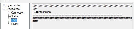

Pimax prolem after firmware update , HDM off green and blue light totali off , piplay 1.1.92, witch Upgrade tool for Pimax(г¤-¦¦д–) not showing FW only programm crash an 0 devices found, piplay not see HDM . I have windows 10 x64 and GTX 1070 , i think problem because FW update time loose connection witch usb and now my Pimax is totali death (( last hope is you, the best support team . I wait your answer maybe you a way how downgrade device or reinstall FW?
After installing “PiSetup_1.2.33_x64”, pimax is disconnecting ever since.
So I tried down-grading to PiSetup_1.1.92_beta_x64, badluck!, nothing works
ever again. I kept doing back and forth so many time now.
These are how they looked like. I don’t think they were like these before.
me show empty debug mode and empty Device Manager only my Gtx (
Log file show this code T:8260 LOGRECORD: bUSBState: -1, bDFUState: 0
