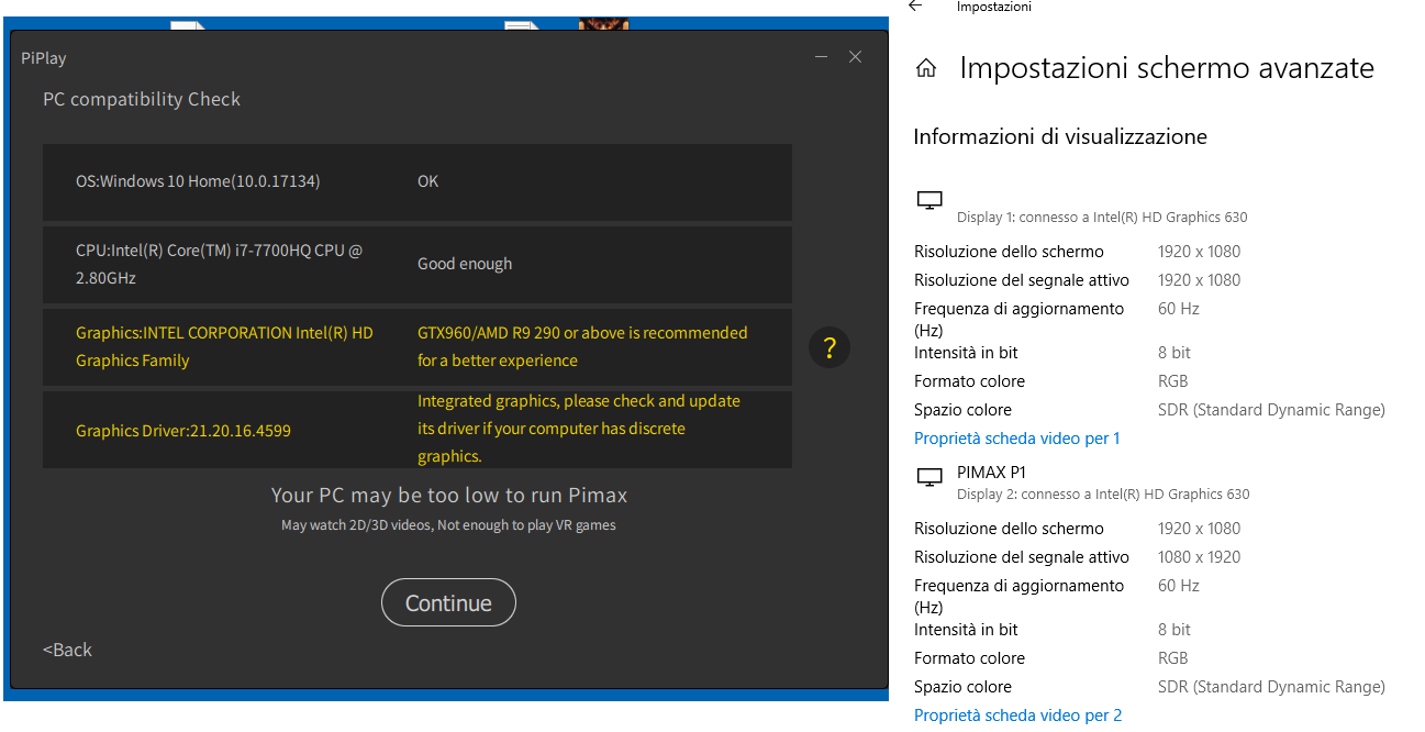

I tried and nothing changed, then I reinstalled PiPlay with antivirus deactivated, administrative permits and through the Nvidia card but according to the compatibility check, PiPlay still recognizing only the intel card, I tried to run a 1080p VR video with PiPlay, it was very laggy and the Steam VR button doesn’t appear.
In conclusion, PiPlay actually can recognize the headset both via HDMI and USB, but if I deactivate the intel card through the device manager, PiPlay stops recognizing the headset via HDMI.
I think that the problem stills in the intel gpu custom card drivers which were installed by the PC manufactur, so I try to see if it is possible to update them from the asus website.
Ok, I I installed correctly the last drivers from the ASUS website for the intel card, reinstalled PiPlay which finally recognized a different version of intel drivers in the PC compatibility check and then… absolutely nothing changed… I’ve also tried Pitool but the problem persists…

Yes, I prioritized the Nvidia card in every way through the Nvidia and Windows control panels, each Pimax program was running on nvidia GPU with its classic overlay (alt + z), I also directly downloaded SteamVR which recognized the headset, and tried to play a VR video with his video player but the performance still the same, poor like that of an Intel HD graphic.
I believe that in desktop computers to avoid that problem, it’s necessary just to connect the headset directly to the port of the dedicated GPU, but with a notebook like mine, I’m afraid that the single HDMI port is hard wired with the integrated video card.
However with SteamVR, I created a system report to better understand what is happening and I would like to share it with the support, @Matthew.Xu let me know.
Yep it is possible your DP is direct to Intel Graphics. Some of these Nvidia Optimus Laptops the Nvidia card is only connected to Laptop screen.
