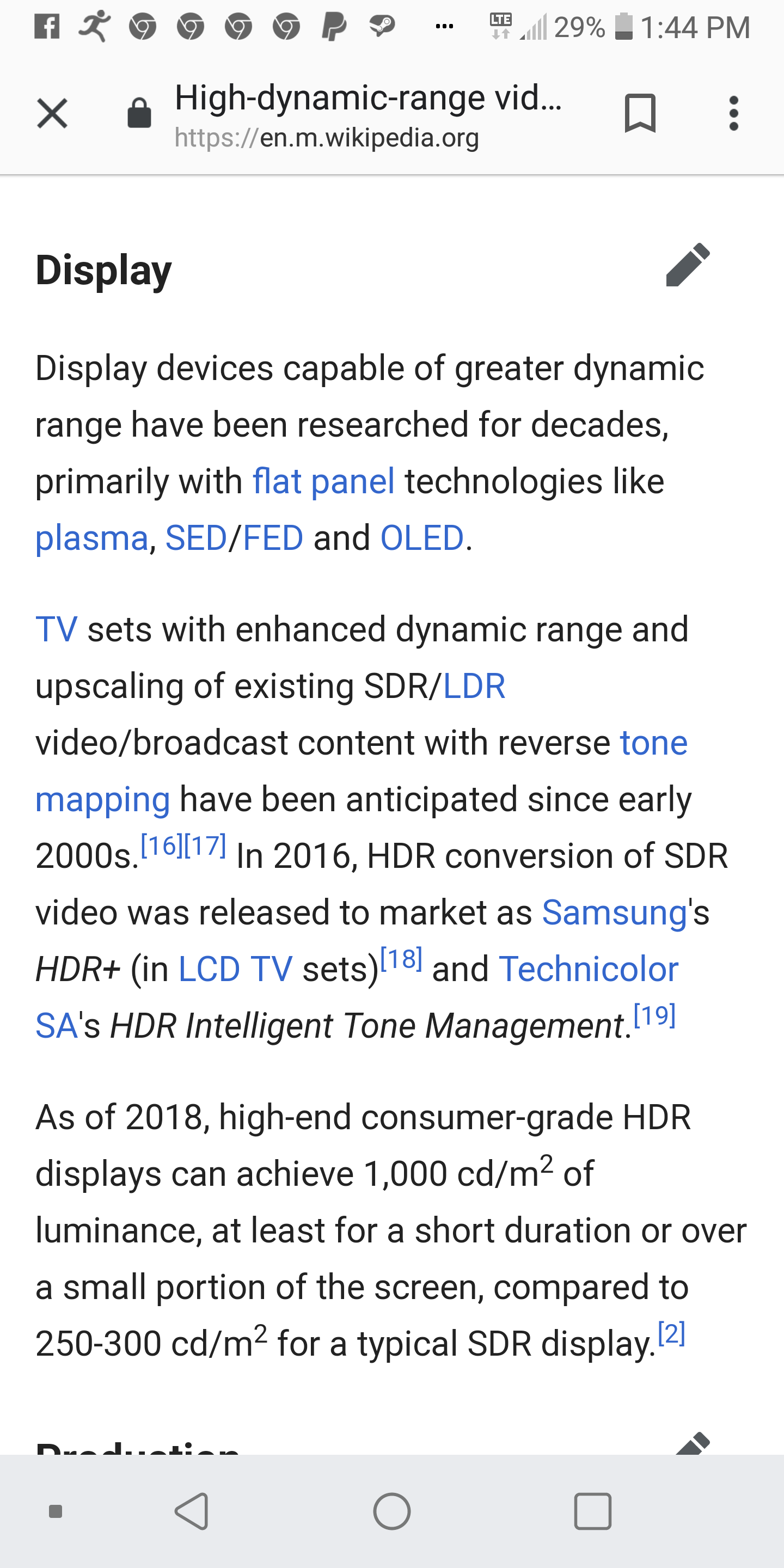

The whole point of HDR is to have really high peak brightness while having better dark scene. the current HDR10 standard is asking for 400 lumens peak brigthness. That could literally damage your eyes at a very short eye distance.
HDR has other benefits as well, like a better color palette.
Keep in mind the Razer phone is hdr compliant. 400 lumens is still considerably less than the 600 to 800 lumen lightbulb. Polarized tint & or blue light reduction reduces potential damage to one’s eyes.
OLED requires less peak brightness to achieve the same result so I guess it could technically be possible.
