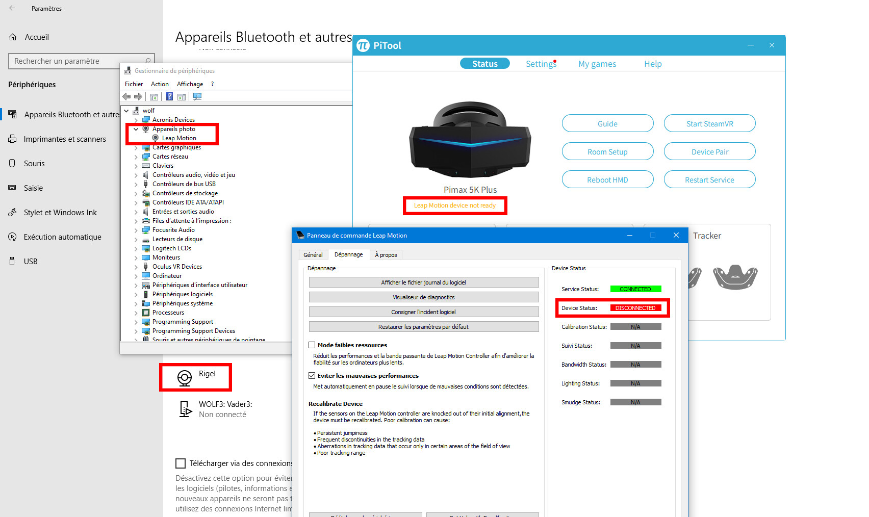

I uninstalled Pitool, every Pimax folders to make a clean install. I tried many usb ports, but all I get is “Leap Motion device not ready”. In leap motion control panel, device status is “disconnected”. Windows recognises a new device when I plug the leap motion.
I could plug an usb-c sdcard adapter to my hmd, it works: the usb-c port is not faulty.
hmd : 5k+ serial 204
Pitool : 1.0.2.087_v2
headset firmware : 2.1.255.269
windows 10 pro, version 20h2

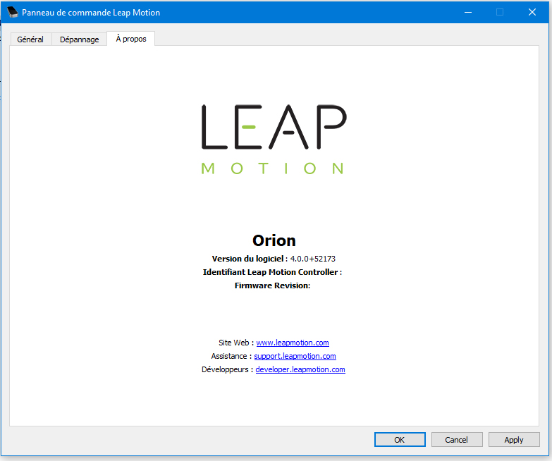

Please can you also share a screenshot of your about tab to see if the hand tracking module is being recognised here?

Here is the about tab :

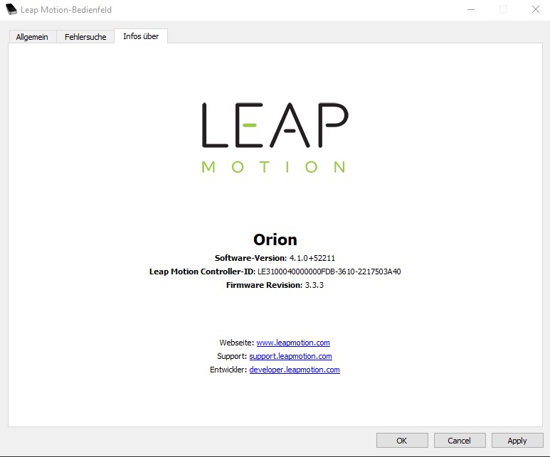

@Ultraleap_Dan
Hello Dan,
I have exactly the same behavior as many users, see also here:
Hand Tracking not working, install issues. Anyone with 5k+/xr have it working?
With a USB 3.0 male to a USB C female cable directly on the PC it works:
Greetings
