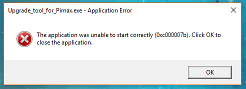

  • Using the upgrade tool. (Ran it with admin permission and with all Pimax services stopped, but still got this error)
    To fix that error, I’ve tried updating/repairing/reinstalling Microsoft .Net Framework and Microsoft Visual C++. No luck.

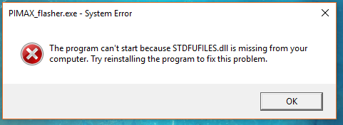

Thanks for the quick reply. I’ve tried his tool, but ultimately runs into the same error.
At first I get this…
Then I used the .dll from another tool and the same error…

The problem 0xc000007b [ after solving first error with missing stdfu.dll you probably had -> coping from /oculus/runtime this file is not a fix ! ] is caused by too new version of PiPlay as you definitelly have 2.x, or even 3.x, but @Sjef made his tool last year, I suppose around V.2017 and since that time Pimax also changed their DLL`s libraries.
All you need is:
  1. FIRST downgrade to 1.2.x [ flash tool will work ! ]
  2. put into DFU mode [ 1) unplug Pimax usb/hdmi, push and hold 3 buttons, plug USB only, wait 8s, release power holding other two for 8s, then release middle, wait 8s, and release last one - clicking it, or option 2) click enter DFU mode in App ]
  3. upgrade FW

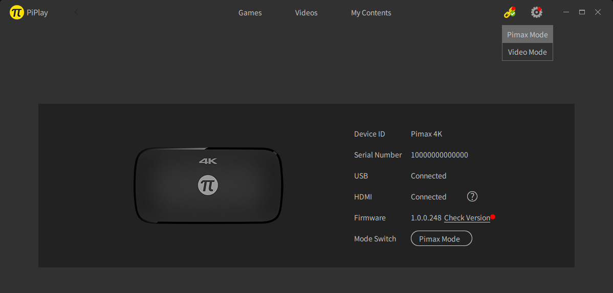

I opened the device and made it flash green/red again, then I uninstalled PiPlay v1.2.97 immediately without running it, and installed v2.0.7.54. The LED on the headset is now blue and this is what I see :smiley: (After switching to Pimax Mode)
Now, when I cover the proximity sensor on the headset, the display turns on and shows the Pimax logo.
I ran some Steam games and…THE HEADSET IS FREAKIN WORKING!!! (Even though the serial number isn’t showing correctly.)
MAN, I have to stress this important step again…DON’T RUN PIPLAY V1.X AFTER UP/DOWNGRADING THE FIRMWARE! IT WILL AUTOMATICALLY UPDATE THE FIRMWARE WHEN YOU RUN IT. UNINSTALL V1.X AND GET THE LATEST VERSION (In my case it’s v2.0.7.54).
