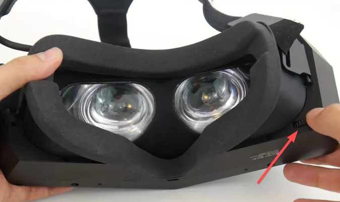

So I got my 5k in yesterday, and the FOV and resolution is great, however, no matter what game I play, I feel slightly cross-eyed, which results in eye strain. Did/does anyone else have this problem? If you managed to fix it, how did you?
I didn’t feel like this in my rift or Vive, so it may just be a result of the canted screens?
What about the IPD adjustment wheel?
Sorry, I should have mentioned that I have it adjusted to roughly my optometrist measured IPD.
Like the vive has a way to extend the screen away from your face to your preferred focal point, perhaps a thicker foam to get it away from your face slightly might help :slight_smile:
Using my narrow face cushion helped slightly, but the feeling is still present. I got a lot of suggestions from Reddit that I will be trying, and will definitely report back on my findings.
You should start with the IPD.
Roughly adjusting it doesn’t cut it for the 5K+/8K, you should really dial it in as closely as possible to your measured IPD, which can be a considerable pain because in my experience, the OSD isn’t reporting accurately enough.
Once you have dialed in IPD, adjusted the fit via e.g. aftermarket foam covers and adjusted for correct tilt, it should feel pretty damn amazing.

What is your ipd? You may need to adjust vertical placement. Congrats on receiving.

Starting certain games without the Parallel Projection setting turned on can cause this feeling. Happened to me when I launched Serious Sam games, and I forgot that they required Parallel Projection. It almost looks right, but it’s just slightly off.
62, gonna do that and the foam mod.
I’ve tried with and without pp.
Which headset did you receive?
5k+ and I’m loving it.
Try checking Parallel Projections setting, like @Jemima2529 proposed. Games like Fallout 4 look kinda right at first, but are a little off, eg overlapping views, which causes eye strain and nausea. could work with Parallel Projections turned on.
Getting this too. First it seems that pimaxs on screen ipd is not perfectly calibrated. So what ever ipd you need will most likely not match the on screen ipd. Also one of your eyes could possibly be closer or away from the center than the other one. (Mine is)
So far I had to dial down the ipd lower than what it should be. Also I notice that if I pull the HMD forward it looks like the convergence is better.
Pimax needs to ship 3 different foam thicknesses with each hmd since there is no way to move the hmd in and out.
Also they need to fix the ipd calibration, because it’s obviously not correct which is bad since most hmd’s do not have this issue. Maybe they can provide and onscreen tool to calibrate?
