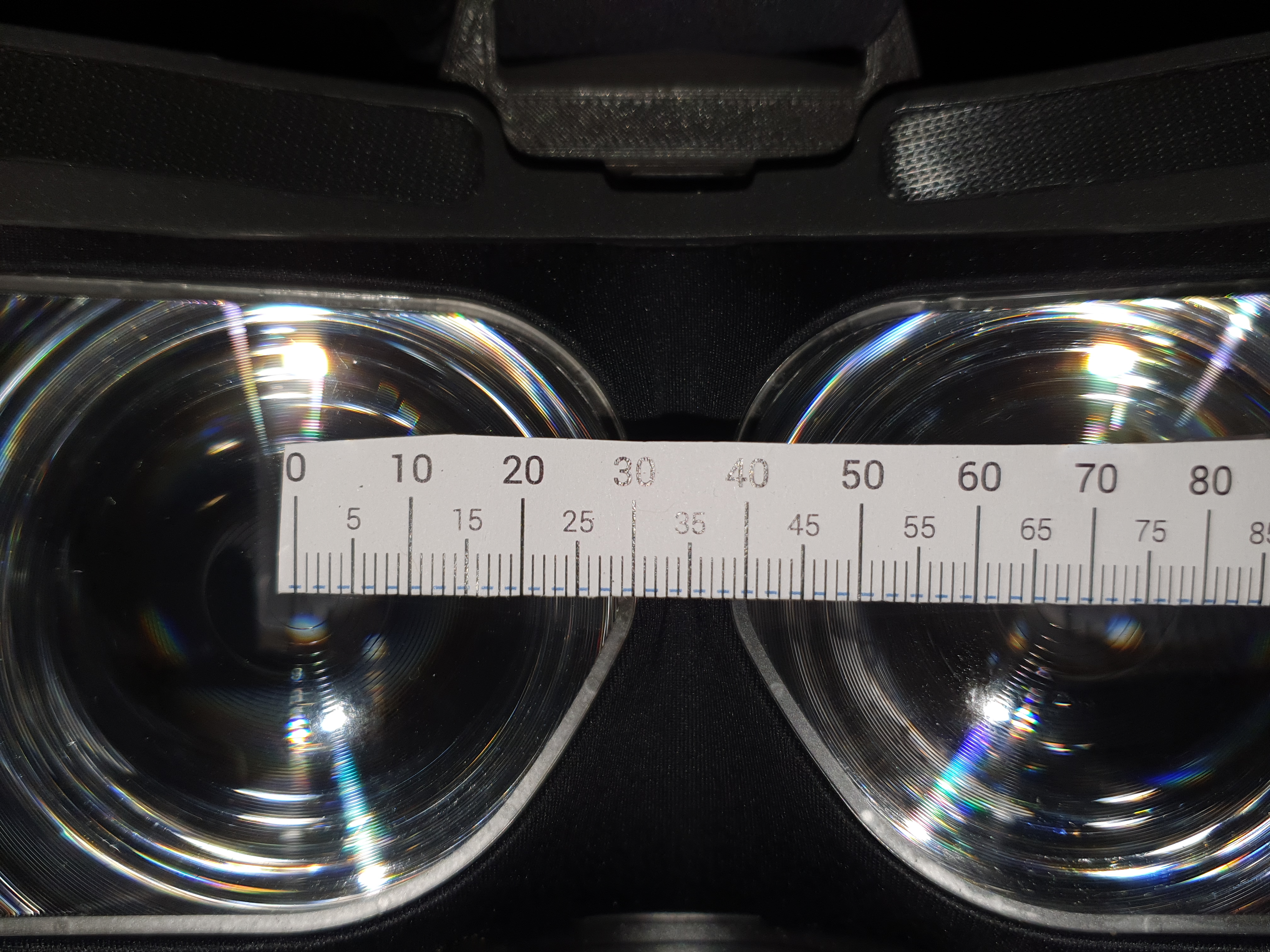

Measure with a ruler the distance between the centers of the lenses in Pimax 5k+. My Pimax 5k+ has minimum 68 mm and maximum 79 mm, My Vive has minimum 60 mm and maximum 75 mm.
This is on the lowest setting (59,9). I got a IPD of 64,5 and also bad eye strains. Just can’t use the Pimax in this condition. Waiting atm for the HP HMD
