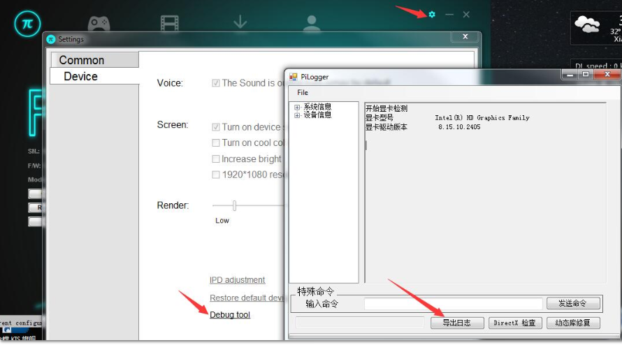

Hi, what’s the color of led on the helmet? What’s the current firmware version of Pimax you used?
Or please use Debug_tool to export logs to support@pimaxvr.com, thanks.

Hi, could you please reinstall Piplay1.2.75 and export logs for me, I will analyze it and find out a solution.
Or could we use Teamviewer, I’m glad to assist you at present.

Hi,
I clicked on buttons as suggested, but it opens a new folder…sorry I can not read Chinese…I will attach the error log that is in the Pimax/Piplay folder if that helps.
Mark
