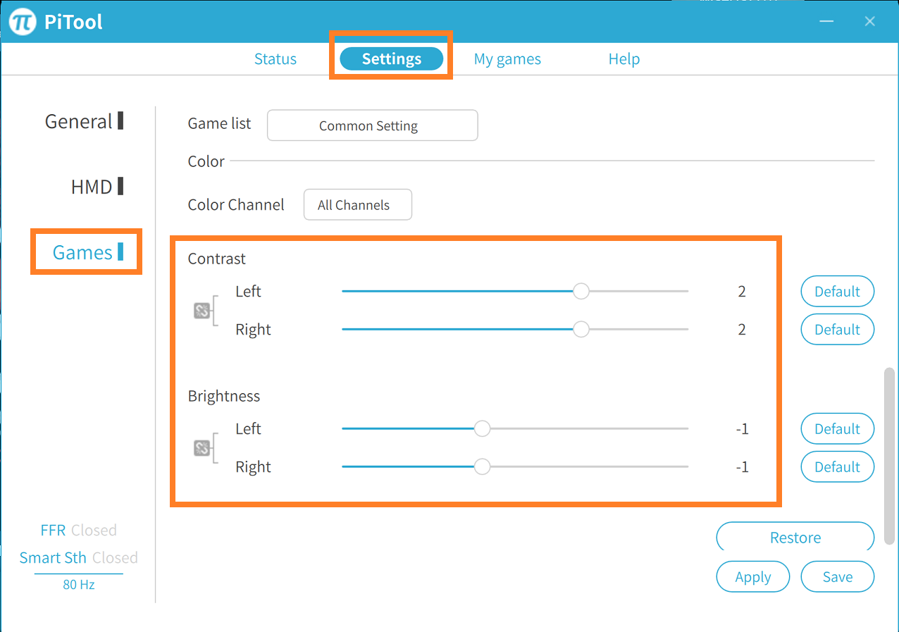

You said the backlight is on low, which should minimize any heat from the panels. You can darken the image in PiTool (just scroll down); I’ve darkened mine and boosted the contrast, to improve the blackness of space in Elite D.

The settings for contrast / brightness are indeed there in Games section (I didn’t expect them there, but more in the HMD section). So I can try that too.
