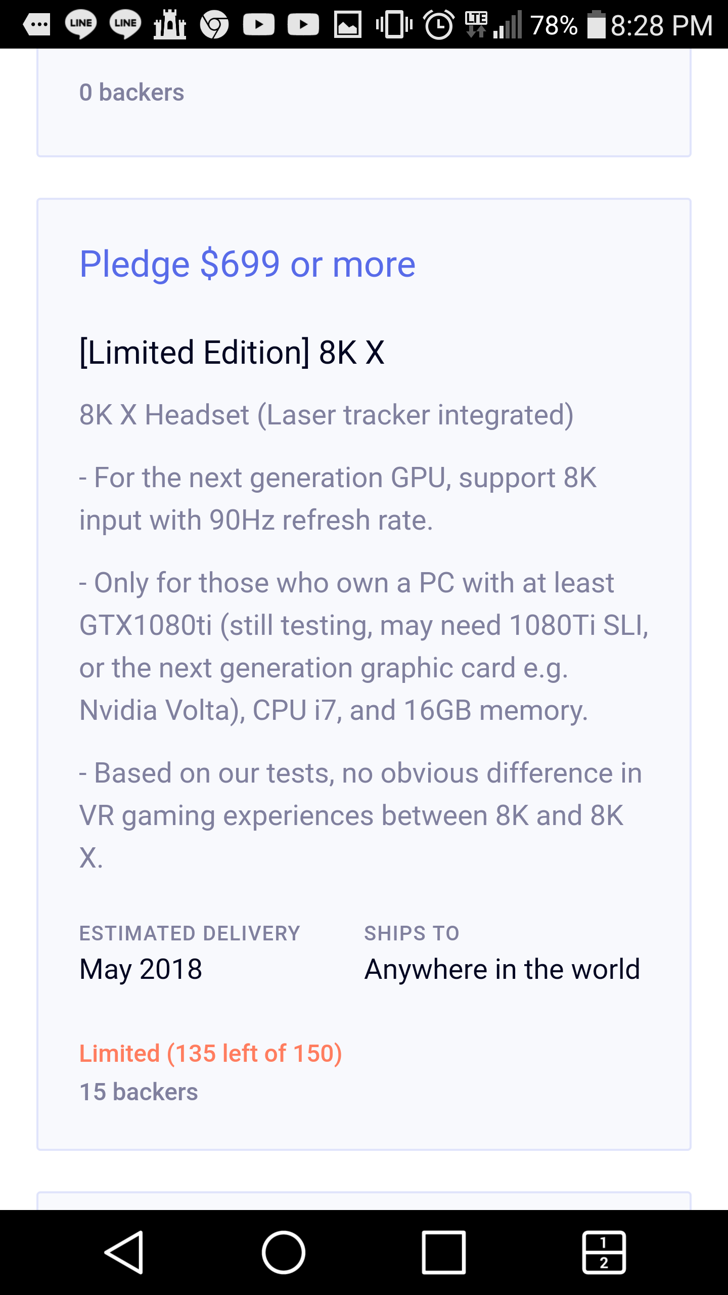

People buying the 8K X essentially have no idea what the actual improvements are. Obviously it’s going to look better but by how much? Can you still see pixels?
Even Pimax says the improvement of the 8K X over the Standard 8K is not very noticeable and their Kickstarter FAQ recommends that we don’t even acquire it.

They must have a prototype of the 8k-X
No obvious difference (meaning have to scrutinize)
I am guessing they have a prototype bridge chip
