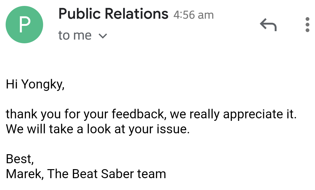

FWIW I have made another attempt to report the issue and got the ack from “Public Relation” that they would pass the info to the devs. For the record the major part of the report I sent:

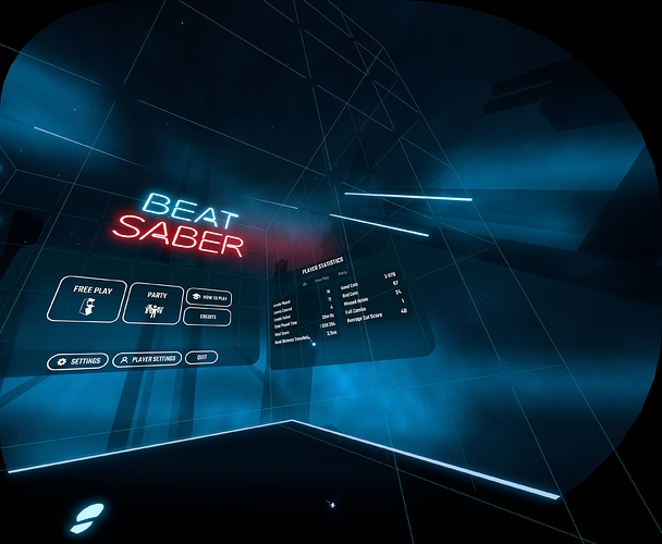

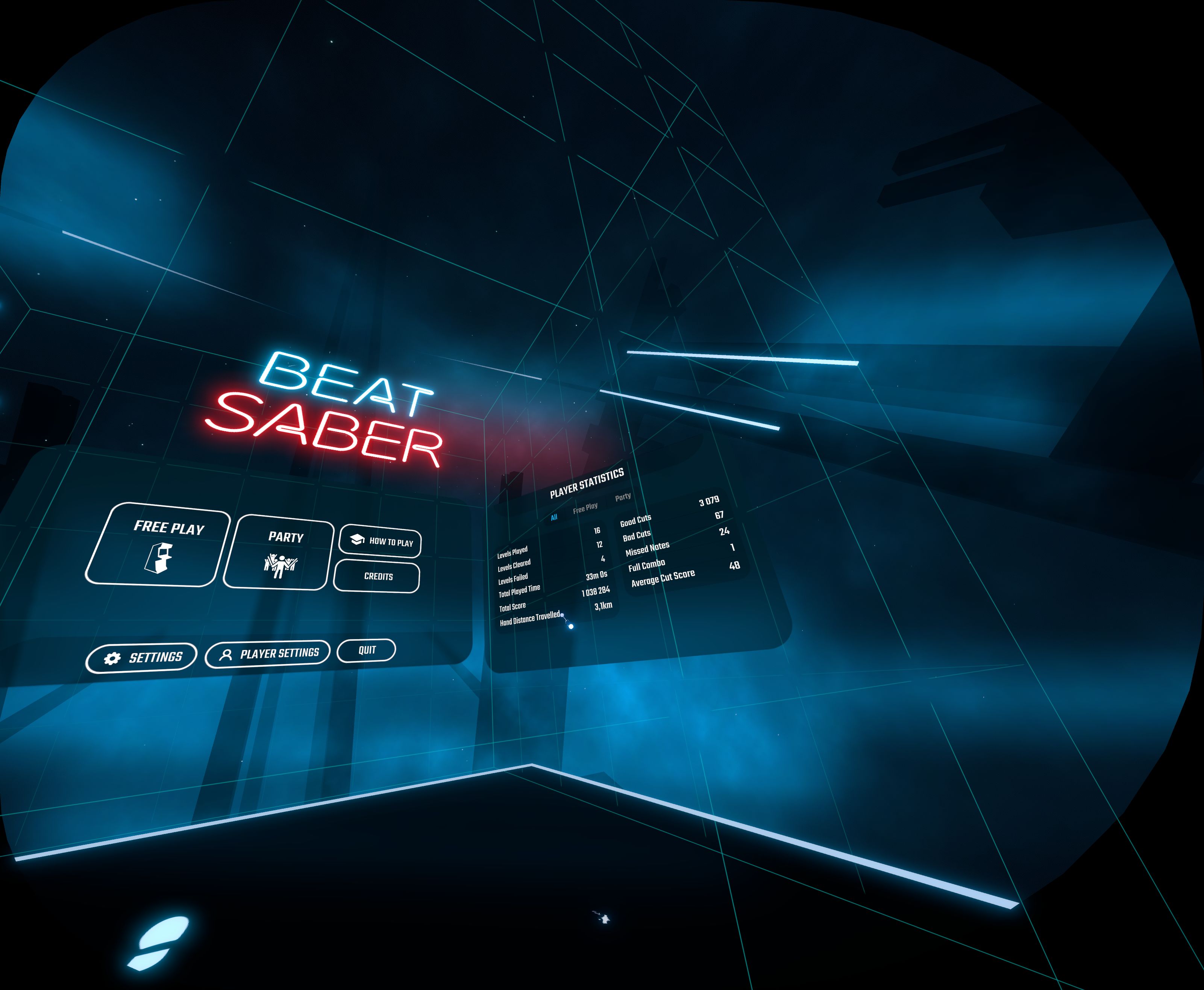

I would like to report a bug (and offer a help if needed) in the “TubeBloom” bloom renderer in Beat Saber, which manifests on Pimax VR headsets (5k+, 8K).
The problem seems to be the custom renderer (shader) which uses only left eye geometry and some “magic” to render the right eye (as observed on game’s BloomPrePass.OnCamerarPrerender or BloomPrePassRenderer.Render which are called only for the left eye view matrix) and uses both projection matrices for single pass rendering for both views.
This does not work on Pimax, because Pimax uses angled displays (https://community.openmr.ai/t/some-thoughts-on-the-ipd-discrepancy/14754) and needs to treat correctly both left and right eye views.
The issue is documented on attached photos where the right eye bloom is 20° to the right (or the geometry is 20° to the left), because the renderer assumes coplanar projection planes and they are in fact angled.
This is as far as could go by debugging the release build of the game with my very limited knowledge of Unity, but I can provide additional info about the Pimax headset if you are interested.
