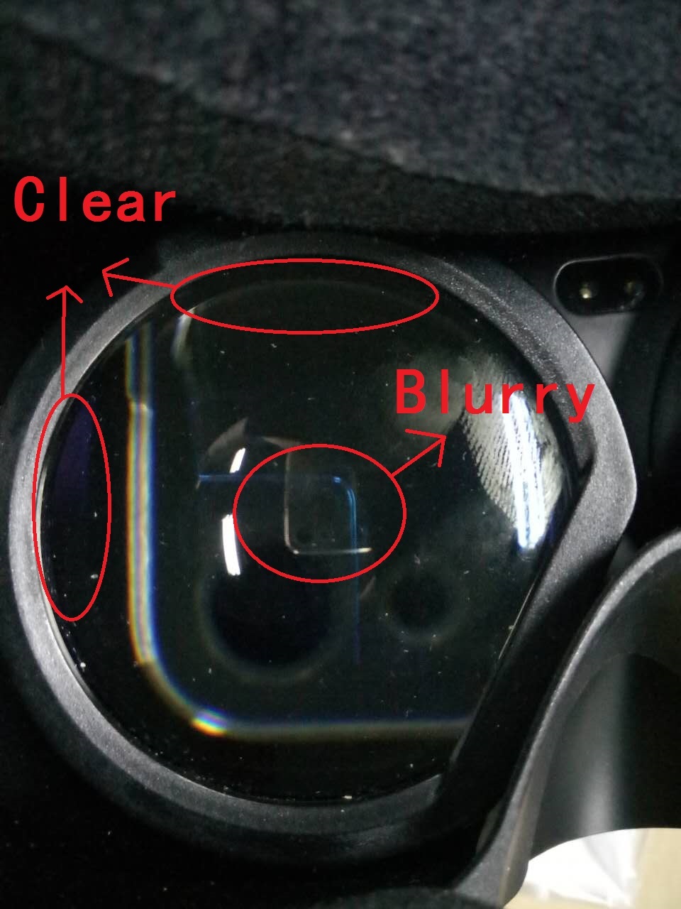

Dear customers:
Thank you for choosing our Pimax 4K VR Headset.
Some customers reflected that their Pimaxs’ center is blurry but edge is clear and they can not solved this problem by IPD setting. We have already received 2 Pimaxs from oversea which have this kind of problem.
According to our technical analysis, there are some issues on the lens’ coating.
We used the seaway ship it. Maybe some lens’ coating were damaged on the ship because of some reasons such as the high humidity, high salinity and extrusion.
We are so sorry about it and we will change another transport way in the future.
So if you have this problem, such as center is blurry but edge is clear and cannot solve this problem by IPD setting, please contact our E-mail: support@pimaxvr.com and please write: “Blurry lens” in your title.
Thank you so much!
Best regards,
Pimax Team
